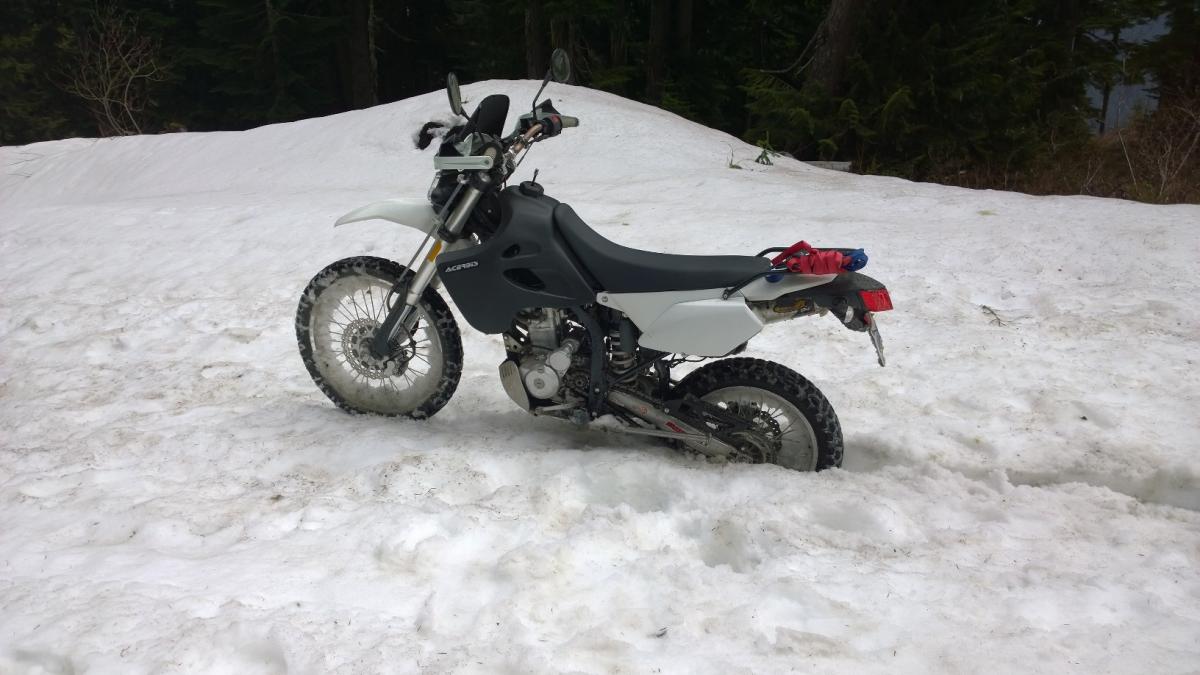

In all honesty I don't think bikes like ours really need large windshields, they have a useful 110km/h - 70mph cruise speed and I've never found that speed to be all that tiring when riding without a screen. Having said that after making my bike fit me better, bar risers and taller bars I noticed a little more windblast coming over the front number plate than I wanted. I ended up doing one of the modified garbage can screens. It does exactly what I want, allows me an easy 110/120 kmh cruise and is not in my way offroad. I'll attach a picture here.. I can take more photos if anyone is interested.

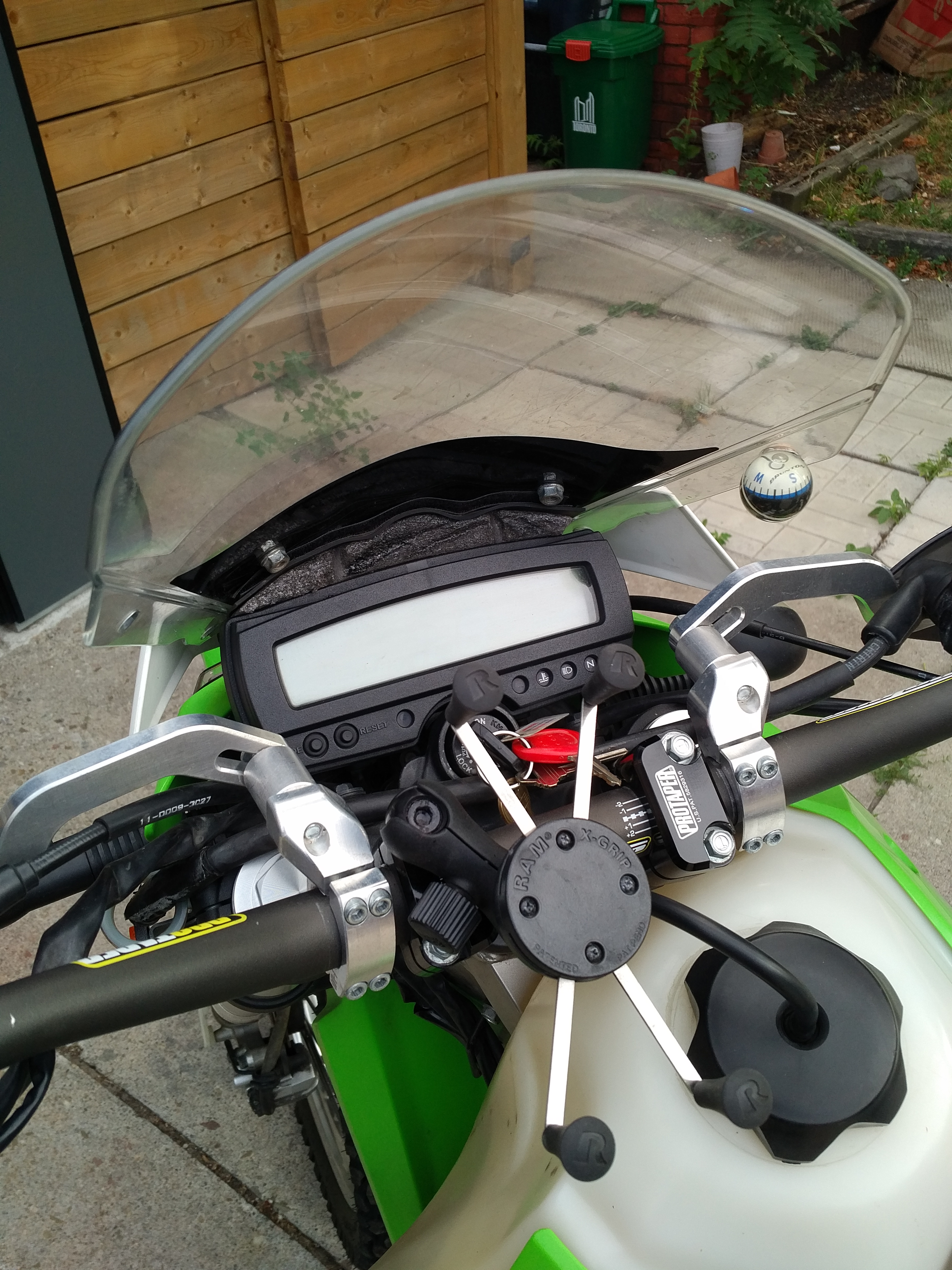

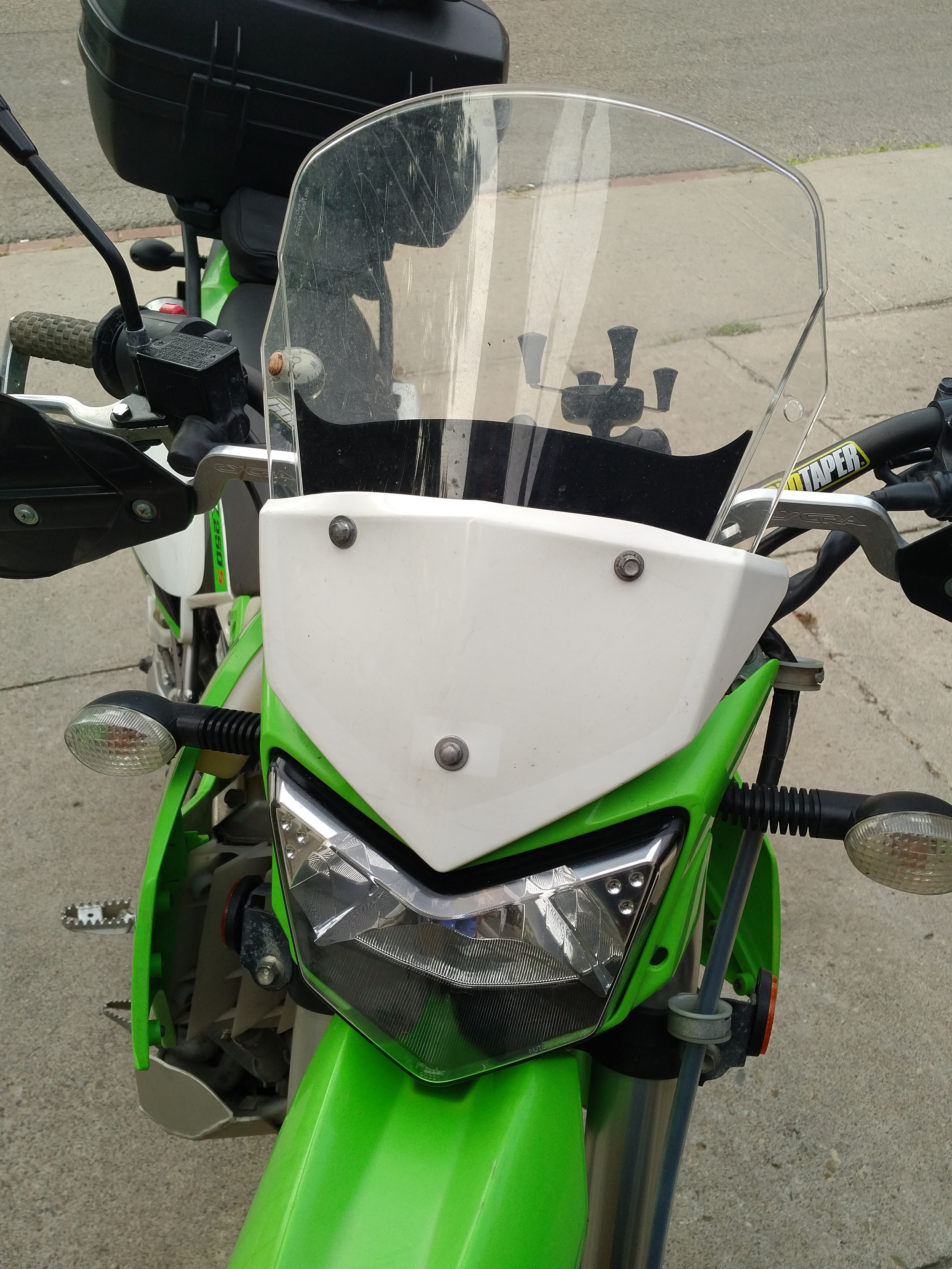

Here's how I installed my windshield. It's a stock KLR650 unit which I found on ebay for $20.
I drilled 3 holes in the front plastics, and 3 matching holes in the windshield. I then filed a slot from the bottom of the windshield to the bottom hole. The bottom bolt is simply sitting there as a pin. The Windshield interfaces with this pin via the filed slot. The top two bolts provide the main attachment points. Thus, I can quickly remove the windshield by removing these two bolts alone.
There is some foam added between the windshield and instrument cluster to keep the vibrations down. The factory rubber and velcro has been moved to the windshield as well. This seems to keep things clean and after about 5,000kms, it has worked well.
There's a ball compass glued into the original mounting arm hole on the right side. I'm on the lookout for a thermometer for the left.
