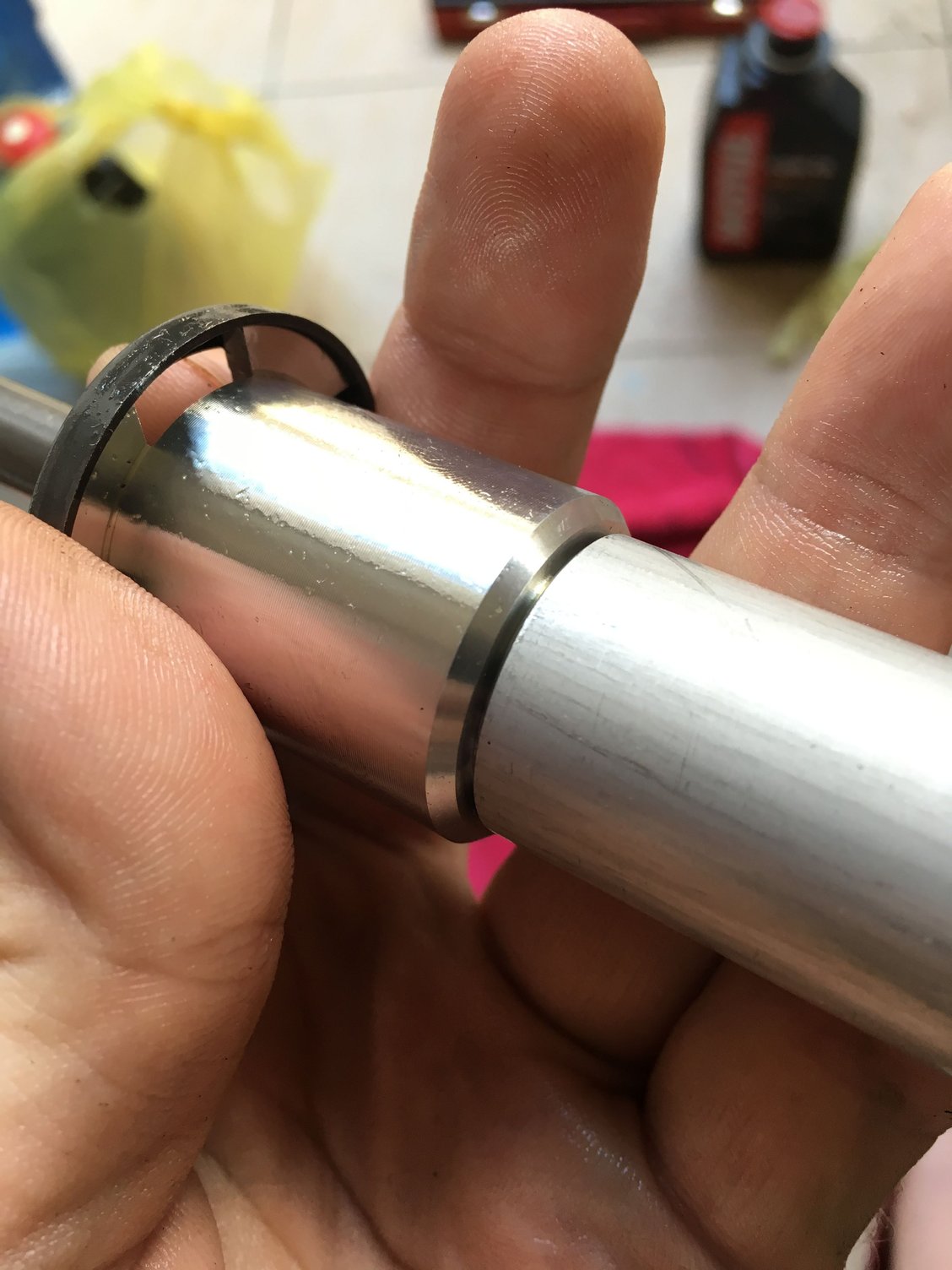

Bringing up the rebound valve, is there really no way to get at it and do a swap with some other valve? What I mean is, nobody has taken on the challenge and tried to do it?
I did my valves recently and was looking at where the rebounds are. Looks like the cylinder could be separated at the line in the pic? Just figure they put them together, wonder how to take them apart. Would be a great mod.

Good question. While a very few have modified the OEM compression stack without notable improvement, I can't recall anyone breaking into the rebound elements...might be someone has. I looked at mine when doing the RTGV kit, but it didn't look promising. And then there's the issue of trying to replace the unit after realizing that such an effort isn't feasible. I'll bet there's no real rocket science inside the rebound section, but accessing and reassembling it might be the fly-in-the-ointment. I'd love to see someone crack one open if it hasn't already been done.
The issue as I see it in the OEM rebound setup is too slow a rebound. When I did my RTGV kit, I went back with a blend of 5W and 2.5W oil. This helped. The fork gets quite a transformation with the proper springs and a compression piston/valve kit like the RTGV, Moto-Pro, etc. I often ride in some decently gnarly terrain out west and at our enduro club's property locally. If you're not actually racing, the modified fork is a fairly remarkable improvement. It's when you really push the bike in whoops at speed or going fast in a rock garden that you notice the rebound damping deficiencies. If I need a bike that I can go warp speed in tough terrain, I need another bike...and that's not just because of the fork. Even so, the KLX fork can be transformed into a good fork for adventure and trail riding with good, competent results.

James at Performance Edge was going to use KX85/100 internals. He said they fit perfectly but the threads are smaller. He couldn't get the local machine shop to turn them down and rethread, they were worried about liability. Then with a '90's KX 250 fork cap you would have adjustable rebound...
