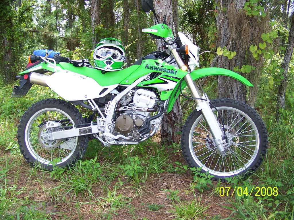

Will try to take some detailed shots this afternoon that shows how they fit. I was originally going to tap the slug in the bar but that idea nixed itself after I broke the tap off in the slug. Doh! Operator error for sure. Ended up drilling out the three spot welds that hold each slug in place and just pulling them out, which is how D-Flex recommends it anyway. On my '07 the slug on the clutch side was a little harder to remove because of some extra paint that had puddled around the slug - Kawi probably dips the bars after the slugs are welded in and the clutch side must hang down so a little extra paint accumulates there.
The directions you'll get from D-Flex are very simple and are all you really need. Couple of things for you to remember though. Make sure you attach the plastic covers before mounting the brackets or you'll have take them back off. (Don't ask me how I know this LOL). Start all of the bolts/screws and tighten them down gradually as they suggest. Use a little baby powder on the rubber sleeve that goes into the handlebars and make sure to start the endnut and partially cover with the sleeve, that will keep the endnut from dropping offinto your handlebars. Getting the long end bolt started is probably that hardest part of the install and one of the reasons for just starting the bolts/screws. Loctite is a good thing....
You may have to fiddle a bit with your controls to get everything to fit to your satisfaction but just be patient. Oh, and double check to make sure that all is fastened up. When you're done those guards should be rock solid. Like I said, will take some more pix soonest.
Dang that green matches really well! I was worreid the green wouldn't mathc worth a crap so I got the black.
We already put mine on, we just tapped holes in the barweights. We'll take pictures in the morning and I was planning on doing a write-up of sorts for those who were wondering.
Oh and they work really well... I laid my bike over tonight and put a nice big scuff on the lefthand side. The guards held their own though!
