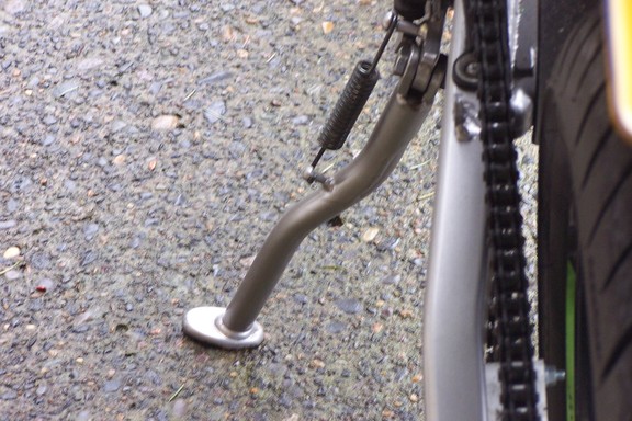

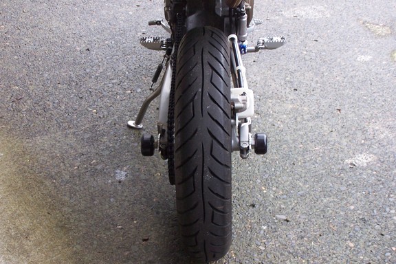

BP88,
here are the pics I said I would send. These are of a 140/70-17 on a 4.00 x 17" rim. It has about 1/2" ofclearance on the nondrive side at swinarm and about the same on the clearance from the chain. From the side picture you can see that it is alot of tire for that little scoot.

Wow, that is a tight fit. Pro Cycle said the 150/60/17 would fit but I would have to shave or remove the chain guard to make it fit. I hope they're right because I'd be royally bummed if it didn't.
