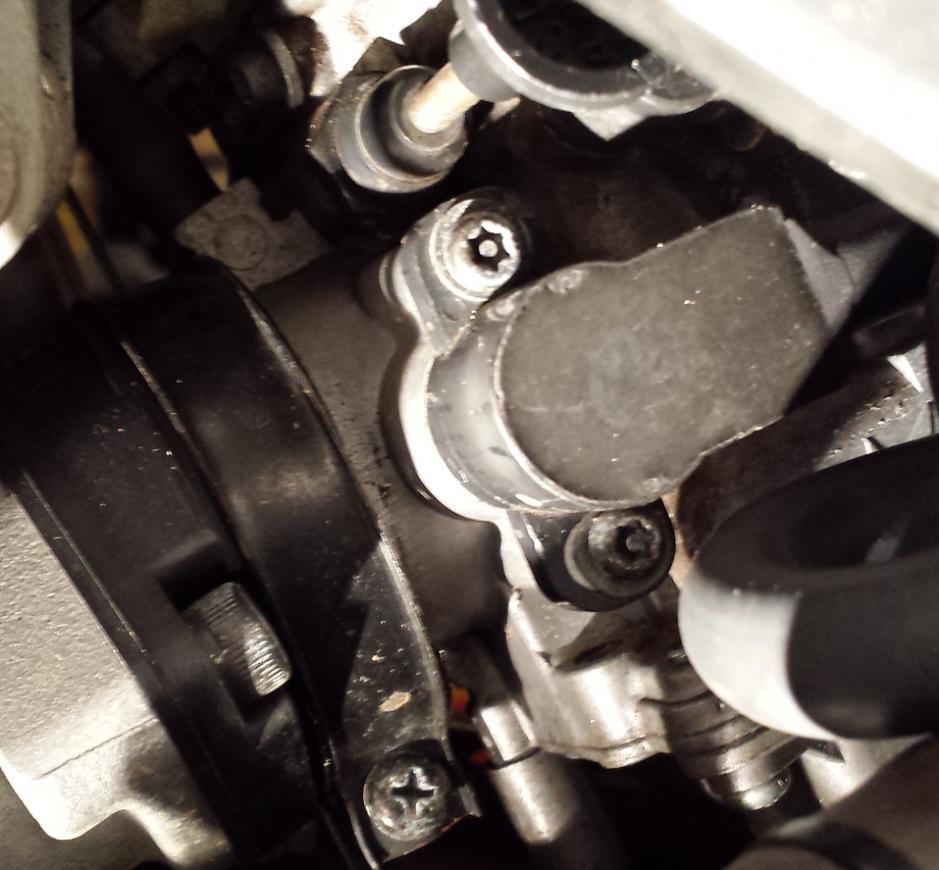

installed the exhaust last night and removed everything down to the carb; removed the smog stuff also. Tonight I hope to remove the carb and re-jet it.
FYI, my 06 has special bolt head attaching the electrical connection to the carb (safety torque ??). If your planning DIY on your 06 carb, you will need a special fitting for your nut driver.

"Tamper proof torx"
I don't recall ever trying to remove those bolts. I think I just disconnected the connection.

ID, you are correct; all I had to do was unplud the elec. connection near the frame. Thanks!
