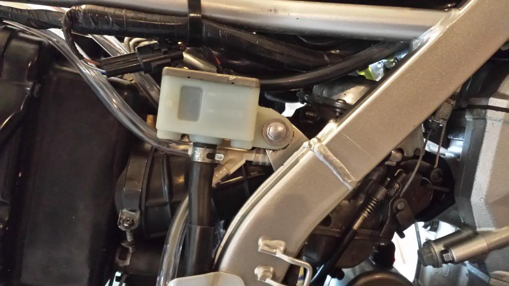

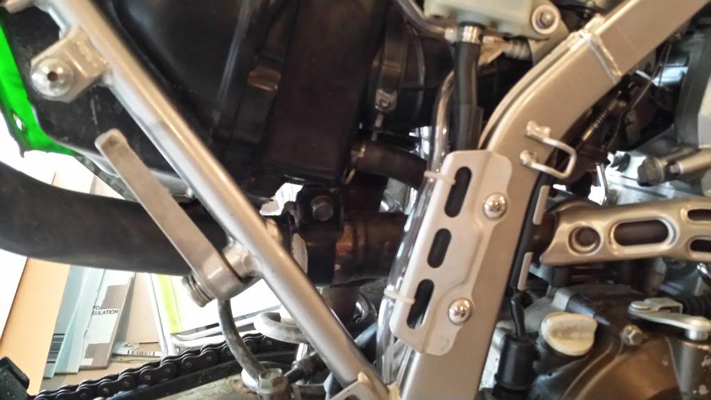

Installed the carb vent lines "Y" mod and tested it through a couple creek crossing, so far so good.
The 'Y' fitting fit perfect behind the R Brake reservoir which holds it securely.

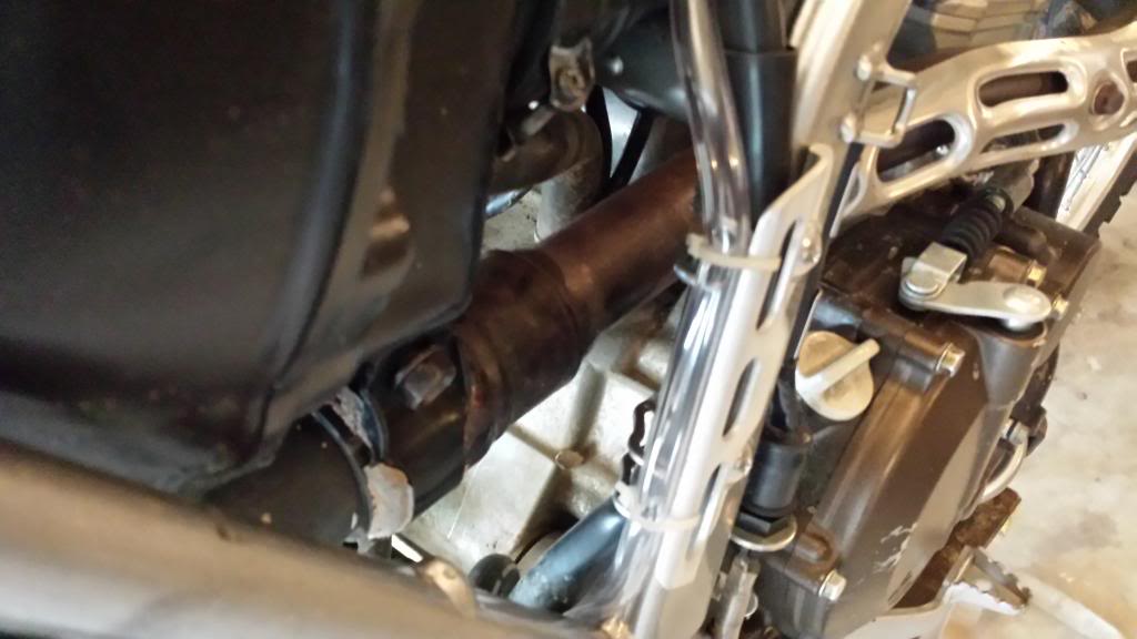

I ran the drain line from this 'Y' beside my R brake line. Name:  20130817_110750.jpg

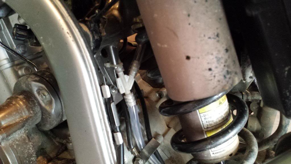

I located the other 'Y' near the rear shock. Name:  20130817_110714.jpg

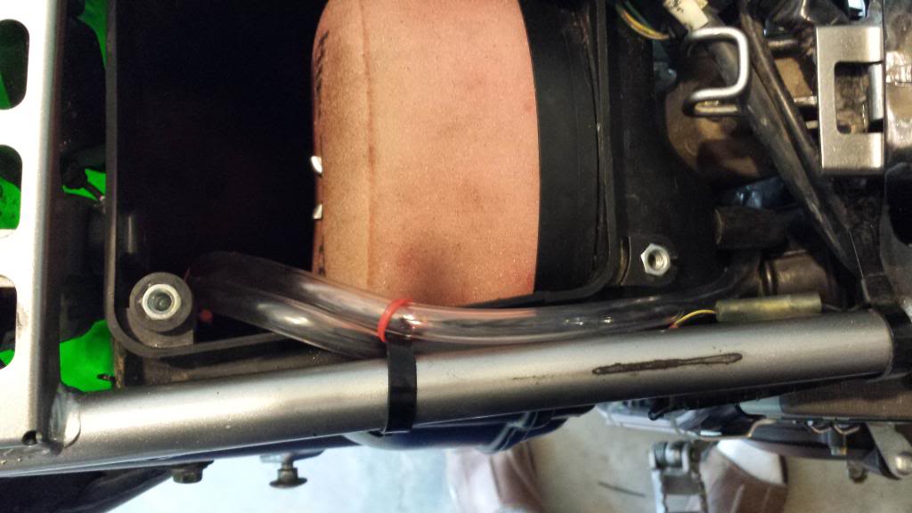

I ran both lines up and into the top of the air box.Name:  20130817_110653.jpg
