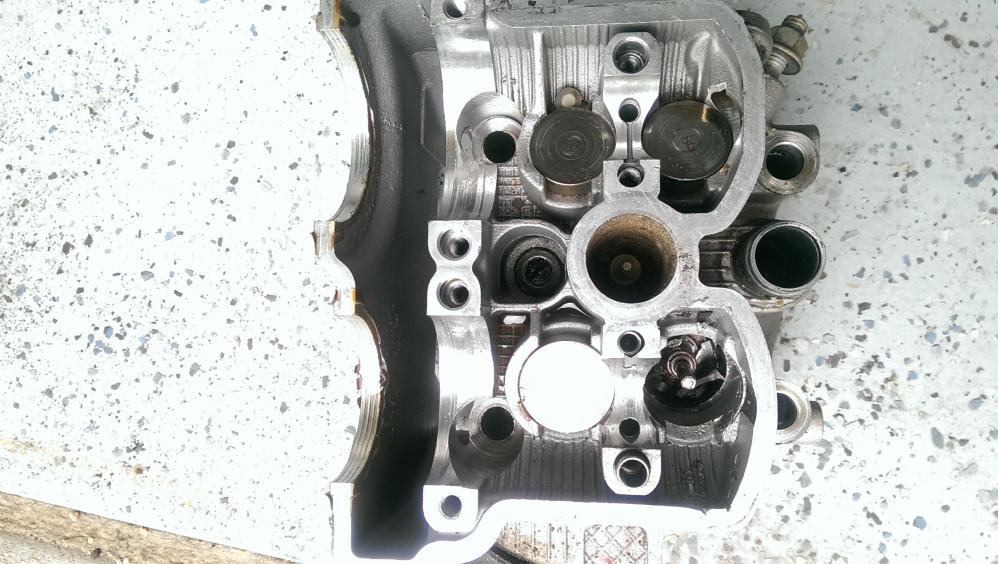

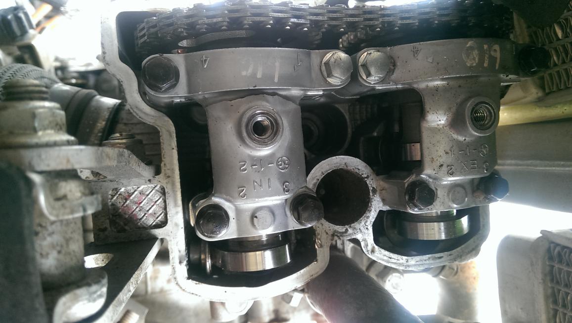

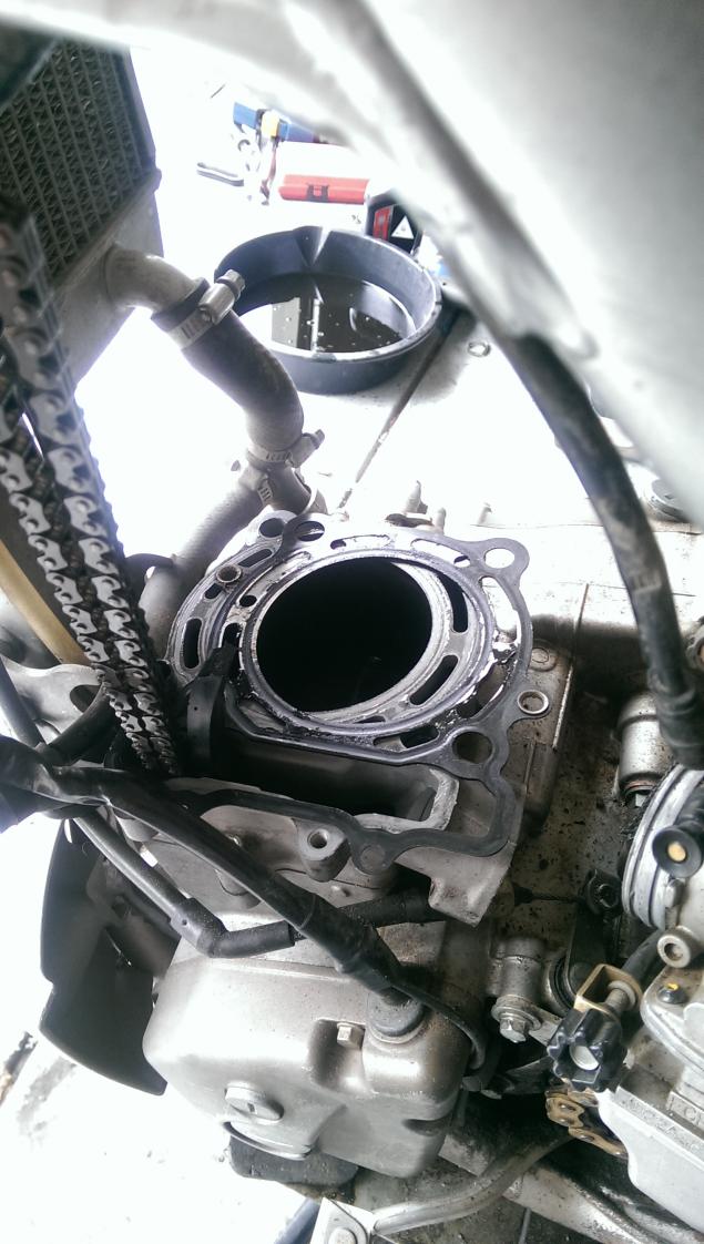

well I did dig into the bike today, and first off im retarded I didnt catch me writing 04 its a 06 kx250f. sorry about that haha. But i did pull the head off and found that the intake came retainer snaped and caused a valve to break as well. I pulled the cylinder out as well and it still has the factory cross hatching and even the piston still looks great! The head is ruined it ground down one of the oil jackets on where the cam sits. SO I am in need of a head if anyone has one for cheap so I can get this thing running soon. I drained the oil and had no metal flakes in the engine. Ill probably pull the clutch covers and oil housing cover to make sure no bits dropped to the bottom end as well.
