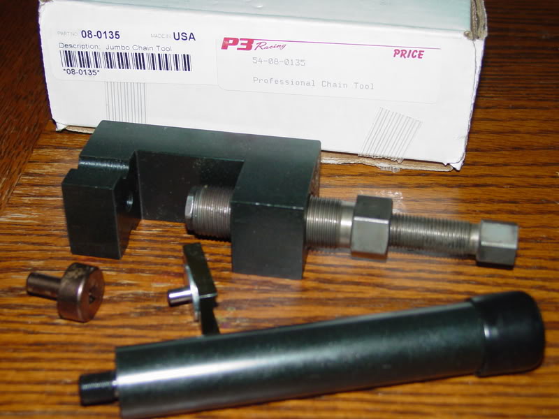

You can grind off the rivets then use a punch to shorten a chain. And/or you can use one of these.
edit: This tool will rivet the master link as well. (if you prefer an endless chain that is)

...and don't buy the cheaper ones...I broke my knock-off tool trying rivet mine. Local shop uses an air hammer to rivet. But the chain breaker thing is way cheaper, and most shops (around here at least) will put the perm. rivet on for free.
