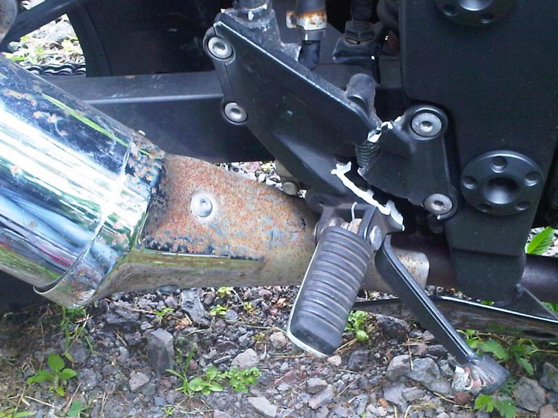

Aloha! I was slipping on some uneven gravel and gently set my bike down on its right and did some major damage. Im trying to buy a replacement part on the internet, but cant seem to figure out what part I need exactly based on the drawings. Can someone help? Also, I am pretty handy. But would I be able to replace it myself? It seems I will have difficulty with the bolts. Mahalo!!

Welcome to KF
Stay, Step Holder P/N: 35063-0386-18R around $58
Easy repair to do. I would prefer using blue thread compound on all of the frame fasteners on a repair like this. Good luck and have fun.

Thank you so much! Your responses are awesome! What would I use to remove the bolts?
Old Jun 3, 2010 | 03:34 AM
Your basic metric open end wrenches probably to loosen and to adjust your break lever tension. Your mm allen wrenches. (do not use the ball end type since the bolts are so soft, the ball end does not provide a good enough working surface and it will strip the bolt heads)
