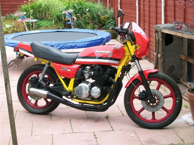

Explain as best I can .....Got fuel,got sparks.Not sure if Ive got leads right.If your stood on left side of bike the left top coil lead goes to the outer left plug.The left lower coil lead goes under the frame to the inner right hand cylinder.Ok,crossing over to the right hand side of the bike where the timing baseplate is.The right top coil lead goes to the outer right plug,the lower right lead goes under the frame to the inner left plug. Hope someone can shed some light on this , its the sort of thing the haynes manual just doesnt show you,just tantalising glimpses,lol.Oh,better say which bike eh???? Its a 1982 gpz750r1 twin shock.Cheers peeps!!!!

So, sitting on the bike. #1 cylinder is on your left, showing the coil leads going to cylinders #2 and to #3. The right coil going to cylinders #1 and to #4. This is a common gpz, zx, Z, KZ and most likely every 4 stroke inline 4 cylinder with the standard 1,2,4,3 firing order.
