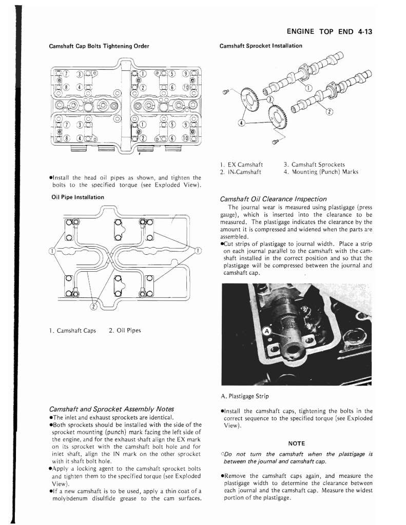

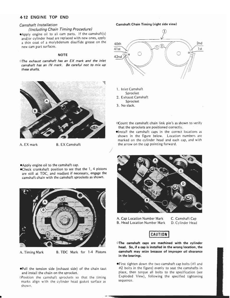

I have the haynes repair manual for it, but i either for lack of sleep or something i cant find how to make sure the bottom end is in time. Meaning i am unsure is i am 180 degrees out or not, and i took the cover off but there are no marks just two dimples on the rotor. also the part i am funny on is i have another one that is the same bike and looking at that one it has a t f and a couple other mark on it. can someone help me out?

I need to fire off my win system in order to post a couple of helpful pics. bbl
Old May 4, 2010 | 02:28 AM
ok, try this....

Looks like your covered, welcome to KF!
