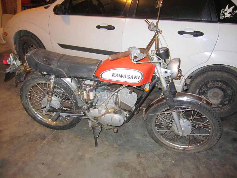

bought this bike for $150, some of the wires are disconnected. including the ignition coil wire. If i post a picture of wires can someone shoot me in the right direction on hooking them all up?
it may not sound right but its not as easy as hooking up same colored wires.

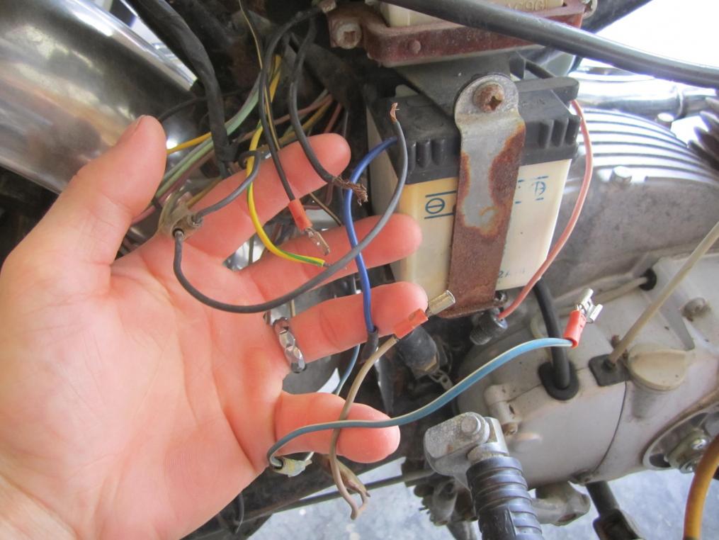

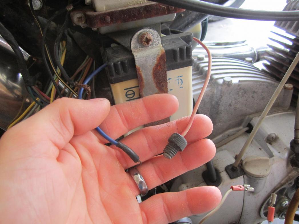

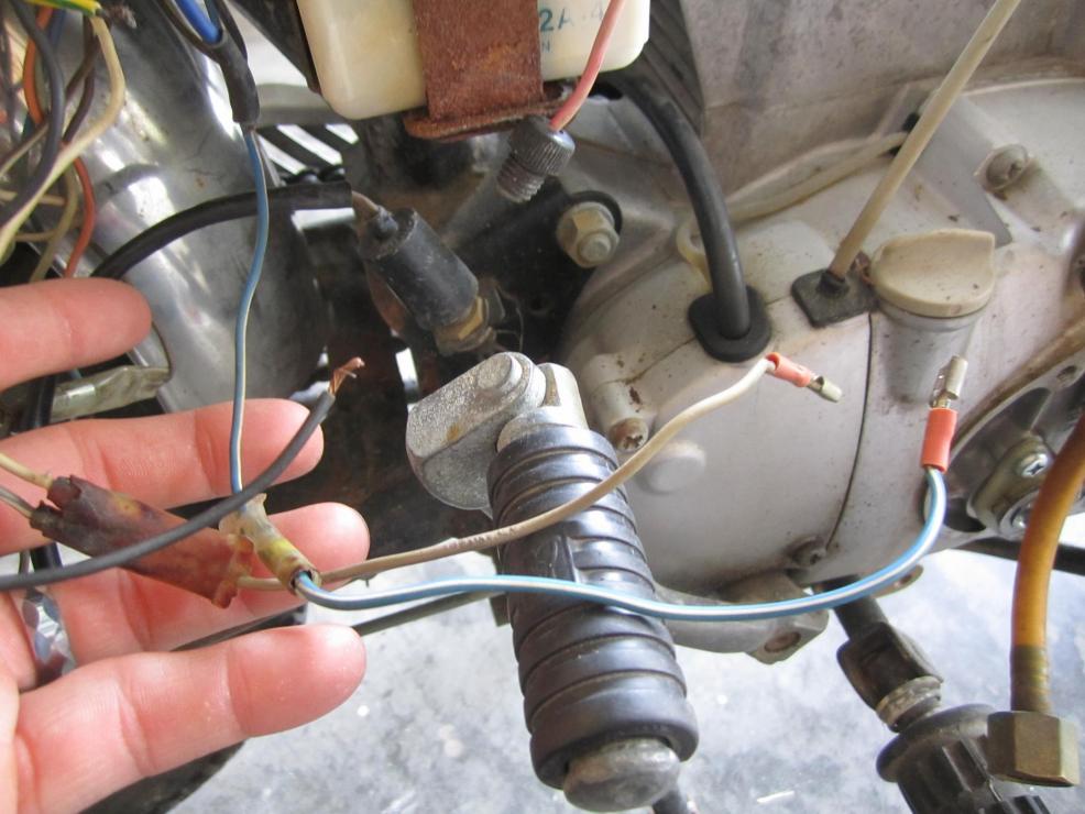

picture with footpeg has wiring coming from ignition key (blue and white).... picture with 1 blue and 1 red are off battery, there is no connectors to hook them up to. at least from what i can tell..... last picture has wires coming from inside housing on left of motor ( yellow, long black) short black with connector comes off back of ignition coil. short black with no connector comes off grounded screw behind ignition coil.... thanks for all your help. i definitely need to get a clymer manual for this old guy.
Attached Thumbnails 69 g3tr wiring problem-wiring.jpg   69 g3tr wiring problem-wiring-battery.jpg   69 g3tr wiring problem-wiring-full.jpg

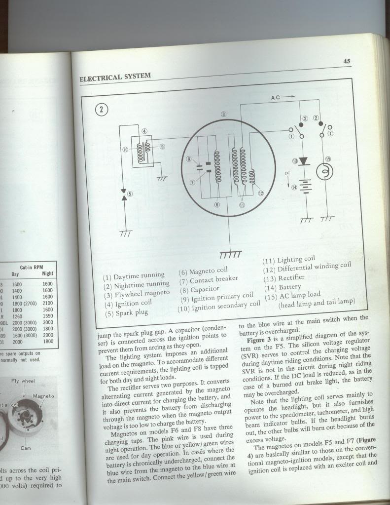

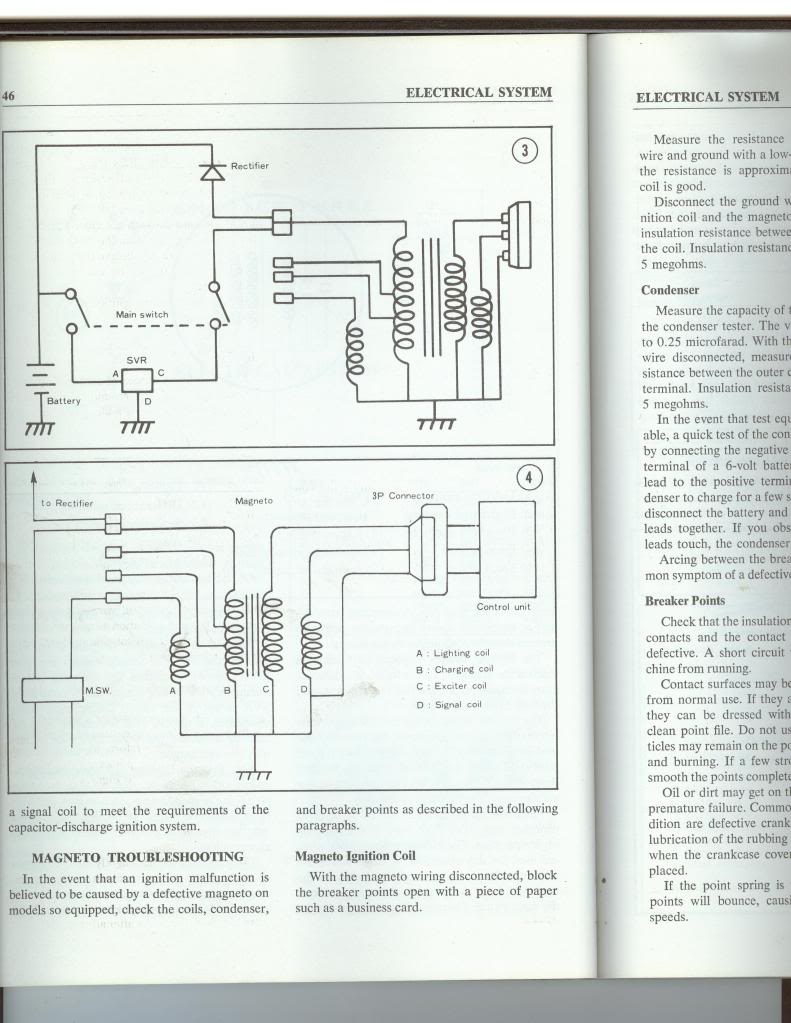

Thanks to both of my Chilton Manuals for the pics.....hope this helps ya out.
