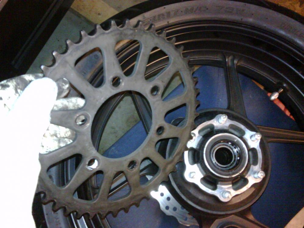

This is the final part of my project. Sorry If it is brief and not a lot of words.
Please if you have any questions or comments, let me know!

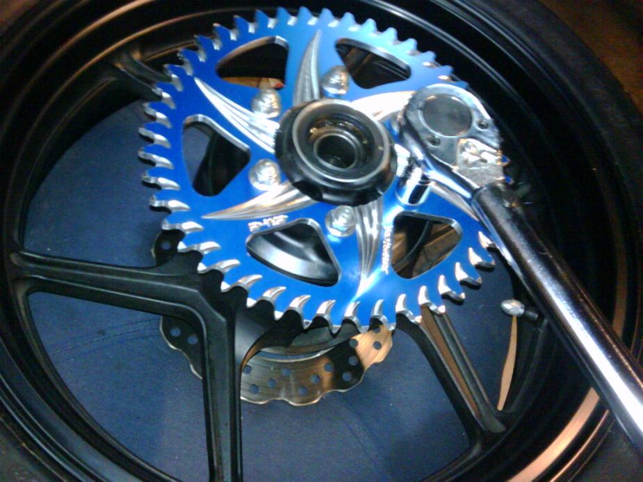

Must important is to torque all hardware according to your service manual.
I actually did this last year and have not had any problems.
You may want to install a SpeedoHealer but I used a GPS to find my true speed or just follow a buddy down the highway at a constant speed! I found my speedometer to show about 10MPH faster. For example if it shows 75 MPH, I'm actually going 65 so no tickets so far. You will run through the gears faster.
So why did I do this? Now that I think of it, not sure! It does take off quicker and easier to redline, but in truth it's not that much different!
