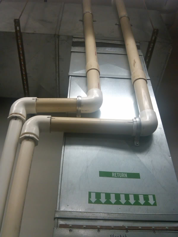

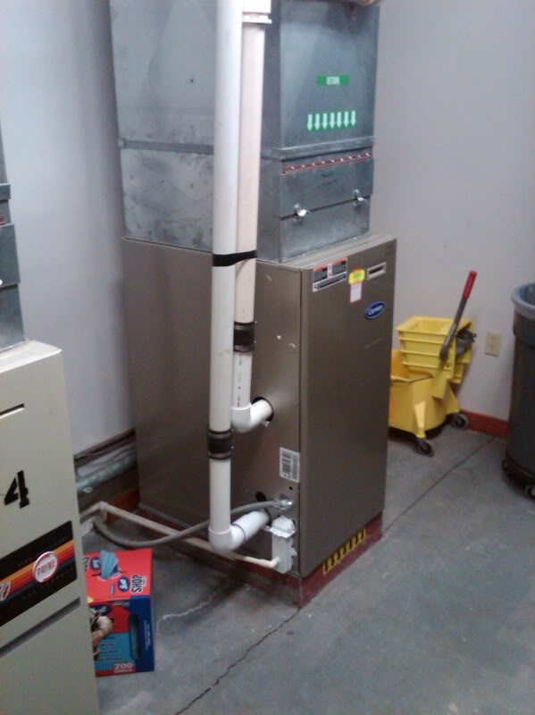

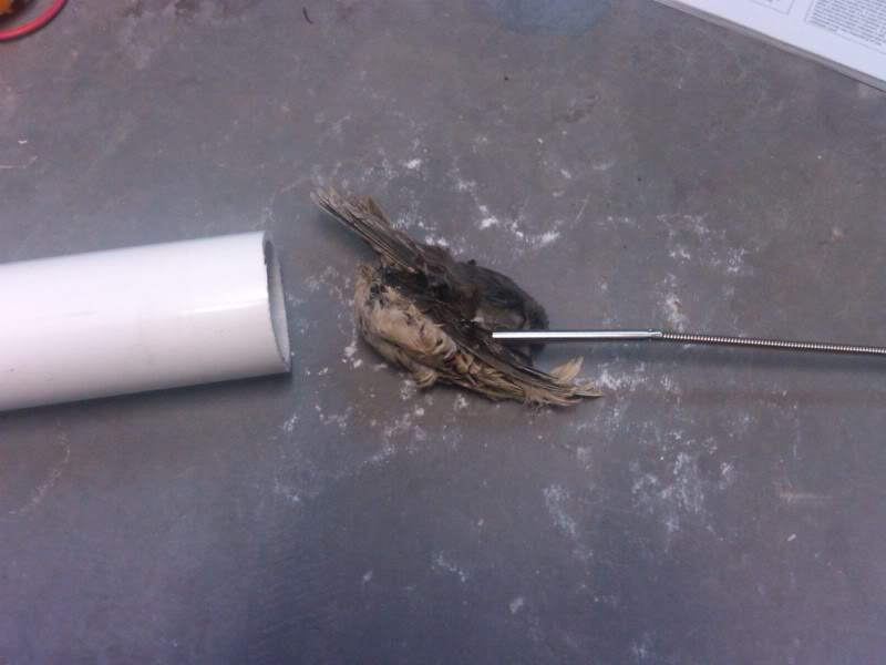

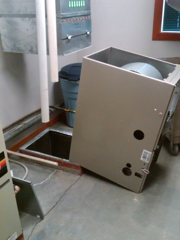

Well, for the second time in 15 years, I found a bird....actually make that a pair of birds stuck in the exhaust of one of our furnaces. I installed this furnace 11 months ago, and this morning as I walked into my boss' office I noticed how cold it was. Since he never complains about anything, I didn't know that it was cold last week. So off I go to see what's the dealio.
Picture from December 09 installing the new furnace.

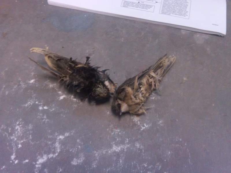

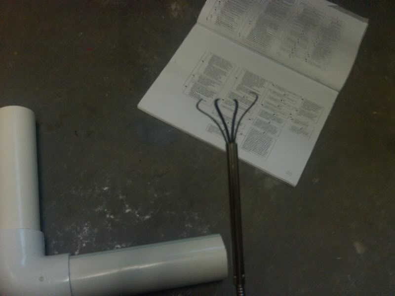

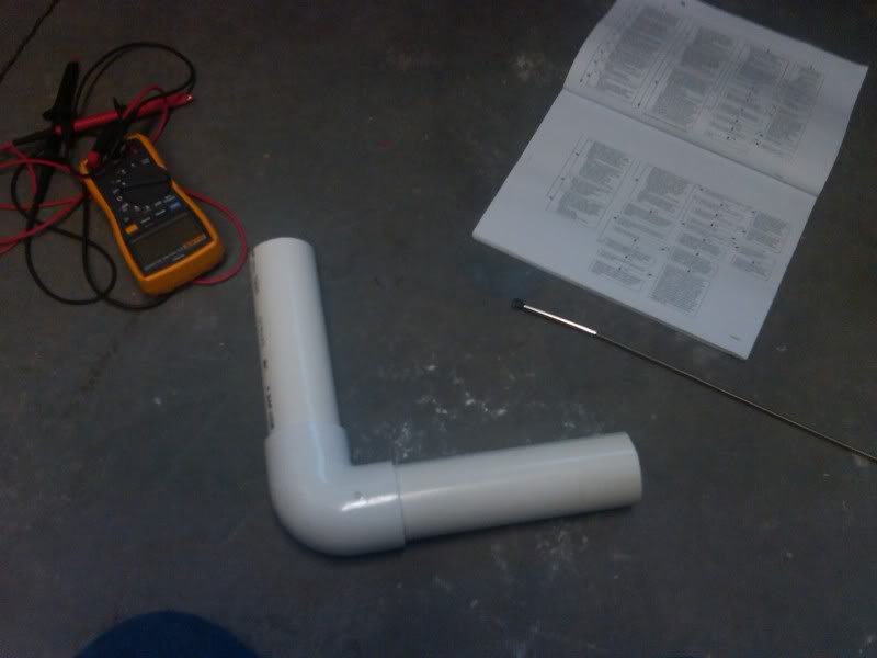

As I started going through the Dichotomous key, the last thing on the list was to make sure that the exhaust was not plugged. After taking off the pipe this is what I discovered.
That's sad....

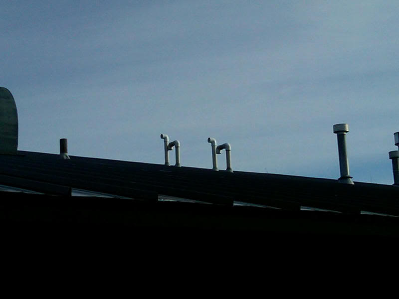

That means that those two birds flew straight down the 3 inch pipe on the roof, and went through 2 90's and then got stuck together in the last 90 which was necked down to 2 inches. That's where they sat, stuck until they dehydrated...... I feel bad for them, I know they are just birds, but I hate to see this. I guess I'll have to add a screen to the pipes up top.

hahaha, that is why mesh (bird) screen was invented for those 90% vents. Congrats on the find.

I made some caps a few years ago, drilled as many half inch holes in it as I could, seemed to work fine. I guess I'll do the other 8 furnaces this summer.

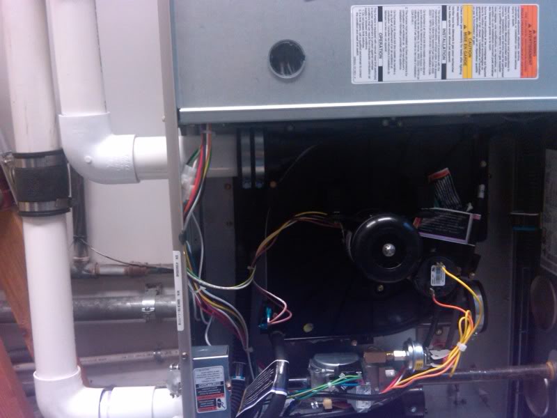

Well fortunately we don't have any leaves around here or seeds. Here is a picture of the current piping to the furnace where the birds got stuck.
