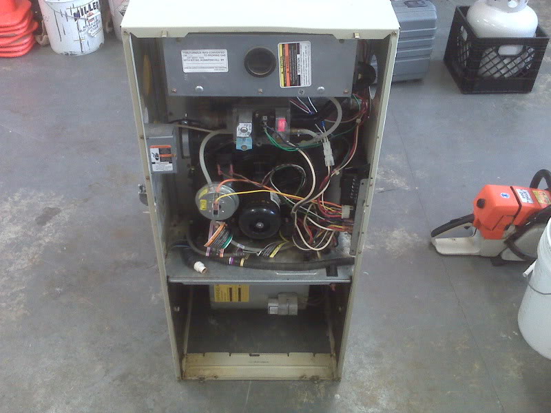

Here are a few pics of what I have been up to lately. It's certainly a wake up call to really tighten my procedures and keep these things clean.
That's the furnace sitting in my shop, well its all apart now.

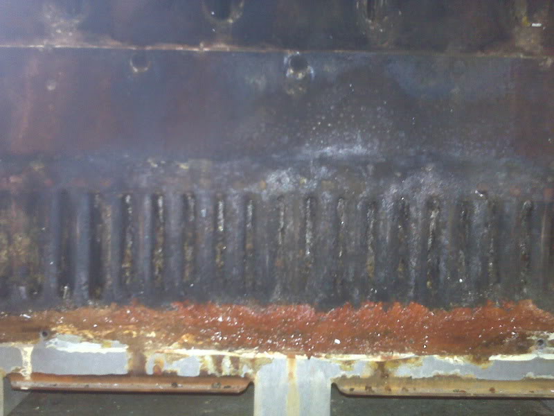

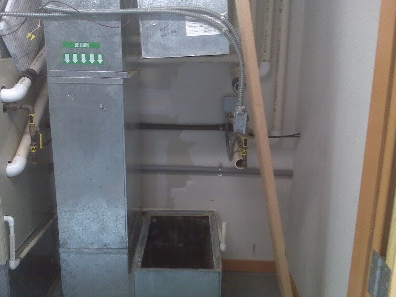

This is where it was.....
Here is the heat exchanger where the exhaust is supposed to get out, and as you can see the exhaust was not getting out so it backs up in the furnace and either causes the roll out switch to shut the furnace down or it cracks the heat tubes...or both as you will see in the following pics.

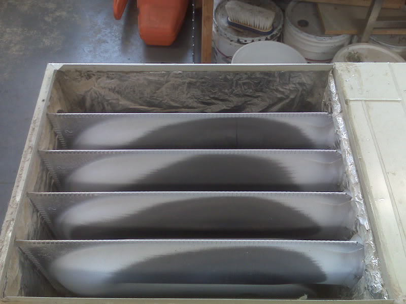

What you see there is over time, water along with dust that turns the exchanger into a sludge factory.
Heat tubes before I took them out. and no you can't even buy a new heat exchanger, they won't even talk about it. Its like the emissions on a car, try buying one small part and see what you run into.

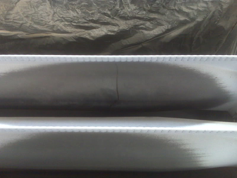

If you look real close you can see the crack, this picture shows it better.

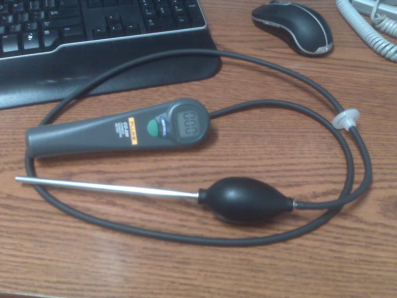

I had one of these Carbon Monoxide detectors with me in one of the apartments that the furnace feeds, and the numbers jumped up to 200 real fast. Its a good thing we had nobody staying with us right now, otherwise they might have become real sick of worse.
