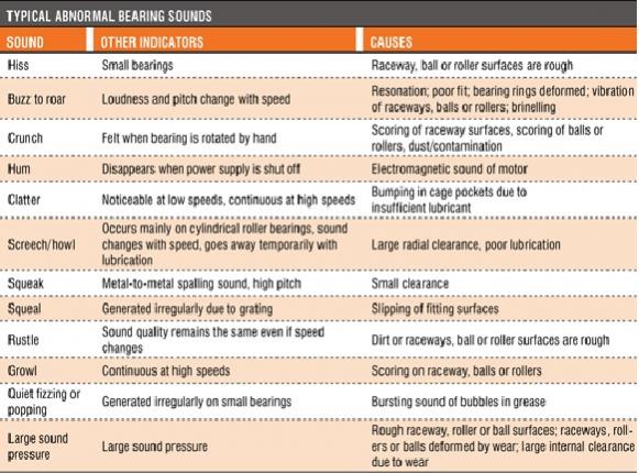

Default Bearing sounds
Copy and post. Good reference material for your garage, right next to the Timken bearing failure poster. (If you don't have a copy of that poster, go to Timken.com. Very cool. I think SKF bearings has one, too.)
