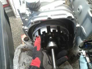

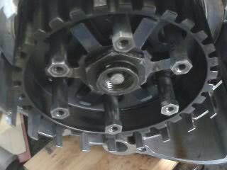

I have a 95 ZX9R engine sitting on my workbench right now. It's left-loose and right-tight. I use and impact with a 36mm socket and a gloved hand to pull the clutch hub nut as you see it in the picture.

If you have access to a welder you can take one of the old steels and weld a handle on it. Then use this in place of a gloved hand to hold the hub while loosening the nut.
