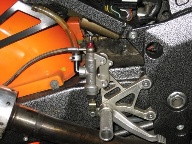

This is a pic of my track bike but you could do the same and use a shorter tube and cleaner of course. You will still have plenty of back brake, something we do not really need anyway.

Just make sure not to pressurize the fluid in the hose when you cap it or the brakes will drag slightly. You can also bleed them to remove any pressure. That is what the rubber diaphram is there for in the stock resevoir; allows for the expansion & contraction of the fluid/ airpressure in the resevoir due to temperature.

If you look you will see the level in the hose is about 1/2 the rest is air and the cap is not a 100 % seal , Ifthe pressure builds up do to the temperature or heat from the exhaust it just leaks out.

Notstock, what are you using for the cap? Brake fluid absorbs moisture from the air so you may want to seal that up better.
