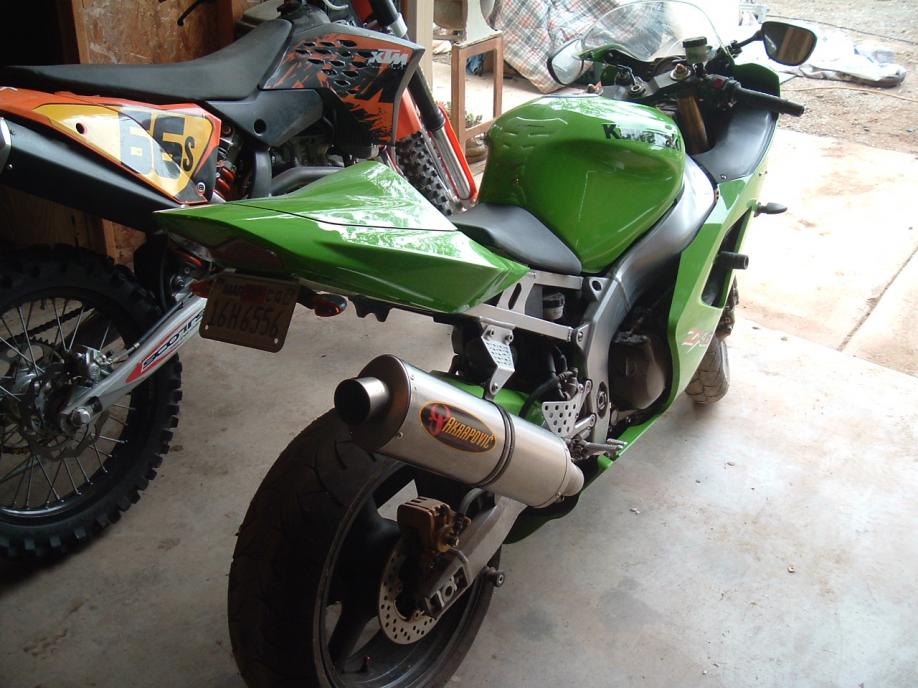

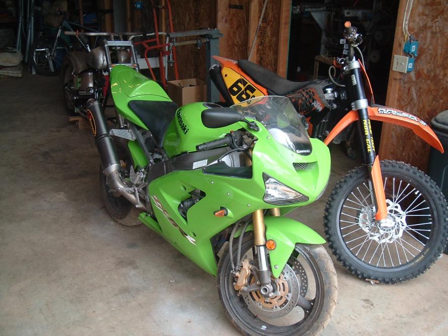

Just for fun here are some pics. Just as the cover came off. Needs a good bath.
Jack

Prom's Avatar
Posts: 5,024
sexy!
