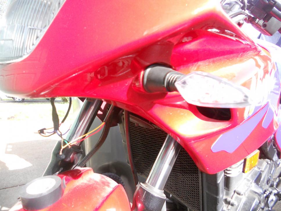

1995 500EX Ninja

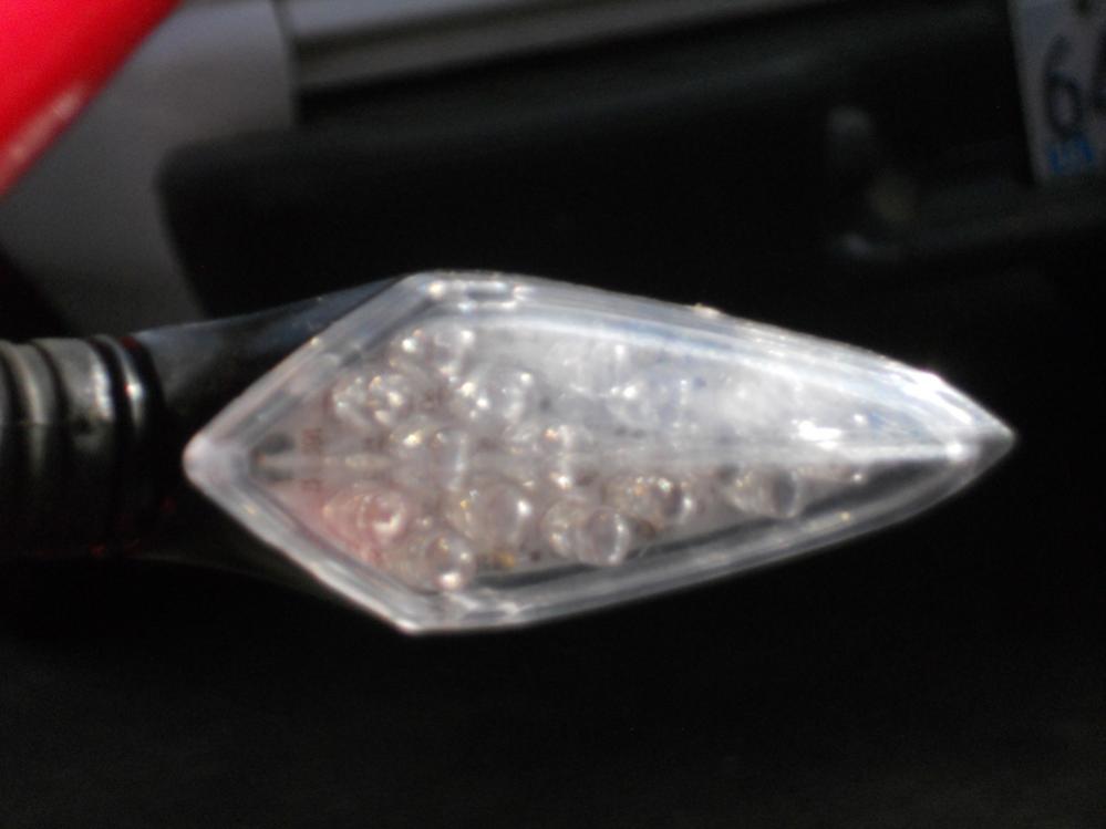

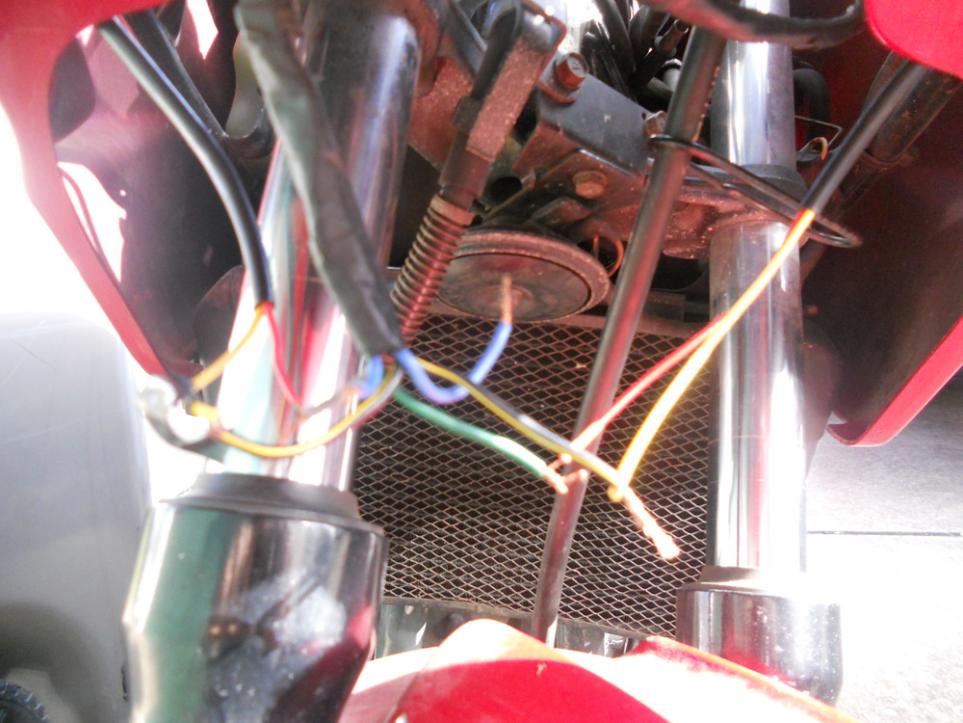

I'm replacing my signals with chinese LEDs. Front stock blinkers had 3 leads, blue for running lights, black yellow for ground, and either grey or green for 12V upon signal (from what I read). Back stock blinkers are just two leads.
New LED blinkers do not have 3 leads, only 2. I understand that to run front running lights via signals would mean tapping into headlight power.

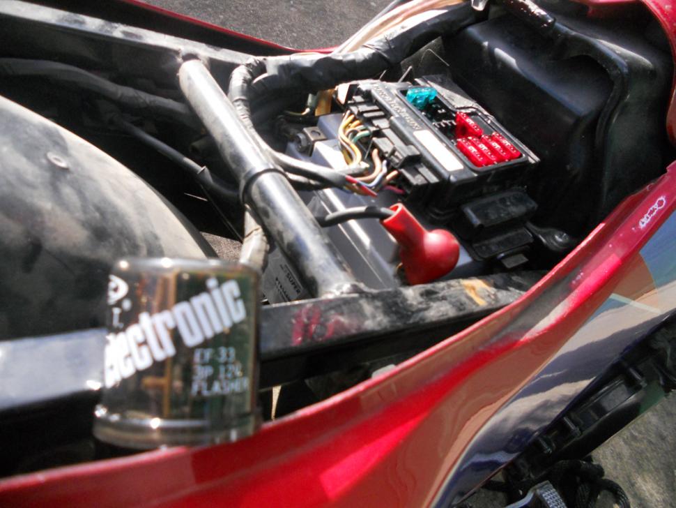

Meantime, hooking up the new EF-33 flasher (3 prong) with or even without the LED lights connected causes the 10A fuse to blow. Also blew a few 15A and a 20A fuse. I've gone through quite a few fuses. The new relay says 25 max amp. The old one doesn't say, perhaps because it's thermal. Maybe it's incompatible.
I understand the LEDs take very little amperage, and I also have 4 resistors but decided to go the electronic flasher route.
I am considering usint 2 of the resistors I bought if I try to run front running lights. Has anyone done this... to get a dim solid LED signal which flashes to bright when the blinkers are on.
I put the stock flasher relay and turn signal on, and it still works, so I don't think anything melted. It seems like a 1A fuse would make more sense, since the LEDs take so very little. This has been a puzzler. Any help is greatly appreciated.

What did the stock flasher and fuses do with the aftermarket leds? A direct short or over resistered I guess would cause a blow. I am not sure if a two wire would meet your expectations. Maybe some lighting wizard will stop by soon. LOL

The LEds with the stock flasher flashed really fast when I installed one, but didn't flash at all when I installed the rear. That's when I looked into resisters, then into an electronic flasher. I think maybe I got the wrong 3 prong flasher.
