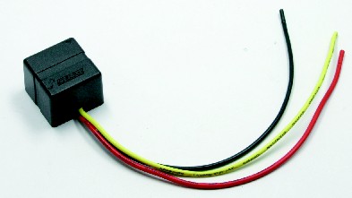

This is the one I installed, from wheelingcyclesupply.com...works great...easy install.

That looks like the ones I see most poeple using here in Japan.
+1 on what Maverick said about load resistors being the 'just dumb' option. Why would you want to install 4 load resistors when one flasher will do the job even better? Once you've done that, you can run bulbs, LED's or both.
