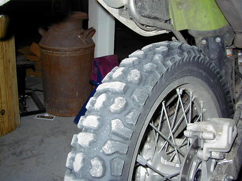

Tire new...

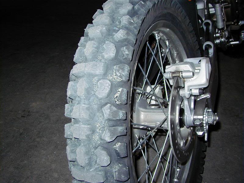

Tire with over 1200 hard miles in 2 months (It is only 5 1/2 miles from home to work)...
I run the tire pressure at 12-15 psi most of the time. I air the tire up to 20+ psi if I am going to be on the highway for a while. If the tire was run at the higher pressure all the time, it would probably last much longer. Let me stress this, I am very hard on tires. I treat them like I plan on replacing them every month. That way, when they last longer than that, I am pleasantly surprised.
One thing about the C858 - the lugs don't look that tall... Dazjr's picture above looks like a half-worn tire to me, but he said it's new.

I am running the 4.60 x 18 size. Next time I am going to get the 5.10 x 18 size. The lugs, when new, are 1/2" deep. I have found this tire to be quite a bit different than the Trakmaster II besides the obvious. When I needed more traction with the Trakmaster, I let the air pressure down - the lower the better. With the C858, I don't air down the tire as much and sometimes I end up airing it up a few psi to get the traction I need. I put a rim lock on for the Trakmaster, but I don't really need it for the C858. The lowest psi I run now is 13, most of the time I run 15 psi. I would run as low as 8 psi with the Trakmaster.
I don't claim the C858 is a mud tire, but it is way ahead of the D603 as far as off-road traction goes. A good knobby front tire will help in the mud, too. The stock tires just don't have a lot of traction off-road. They work good for what they are and I really liked them on-road. I guess everything is a compromise with this bike.

Pressure wise I'm running my C858 at 19 as I commute 30 miles roundtrip daily and generally every day I'll grab about 3-4 miles of trail (see my DS ride report for trail info). Dazjr, you said that this tire will flip you over offroad if not careful, did you mean that it would kick out or in a sense that you would wheelie over? If you look at Daz's two pics that is exactly what I was hoping to see, 1200 miles and barely any wear. In the mud I've been riding this past week I've found this tire to be far superior to the 603 even being at 19 psi. I'm thinking about getting this as a front tire when the 603 wears out.
