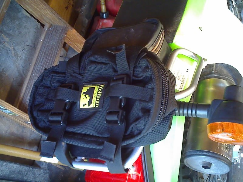

I got this Wolfman Endro bag from one of the members that was selling off stuff. Good deal and I'm very pleased with it. In fact, after many miles of riding on the KLX. I can finally carry along those cheap Kawi tools for just an occasion (along with my own mix of Craftsman). Also, it doubles up as a storage on the go. First items it carried were hair dye and Mike & Ikes.

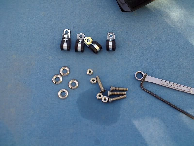

Parts and installation. All parts can be bought from Ace Hardware store.

4x #8 rubber gorment pipe hangers
4x Stainless Steel counter sunk screws, 1/4"-20 1.25" (1" or .75" would be more acceptable)
4x SS nylon lock nuts, 1/4"-20
4x SS finishing flanges

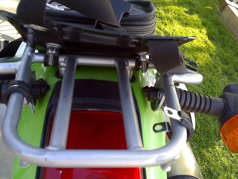

I have the hangers arranged on the rack for installation. I found this to be the best position as it doesn't allow for movenment when installed and prevents unwanted binding of the tool bag plastic base.

Finished results.
