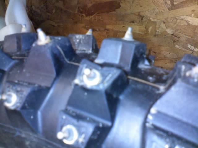

How many screws did you use per tire?, Price? Where did you get them? installation time? I was lazy and bought carbide studded Michelins off Craigslist they work great but I think I got screwed instead of my tire.
No clue about the studs. I bought pro built tires. $600. They grip clear ice better than my KTM supermoto grips road race courses.

See FZ1 Matt's pic for what a screw pattern should look like. My tires are a used pair built by Jeff Freddette. Folks who have done this for a while will tell you there is a big difference in pro-built vs. rookie-built tires. The pros start by shaping the profile of the tires and will use different shapres for left turn tracks, right turn tracks or road courses. Then the line the tire with the carcass of an old street tire, which they shave so that it fiits smoothly inside the tire so that it doesn't pinch the tube. Then they drill the pattern in the lugs and set screws in - usually 1-inch cold cutters or the like. Then they will tune the tire by aligning the screw slots into patterns to increase or decrease grip. Then they use wraps so that the screws only touch ice; they don't even roll them around the garage without wraps on. Build your own to get a taste of it, but then either upgrade to pro-buit or experiment with the different factors on your own.
Carbide studs are made for running on winter roads in the same fashion as studded snow tires on cars. Running cold cutters or sheet metal screws on the road is frightening. They quickly wear down to smoothe metal ***** which don't grip anything.

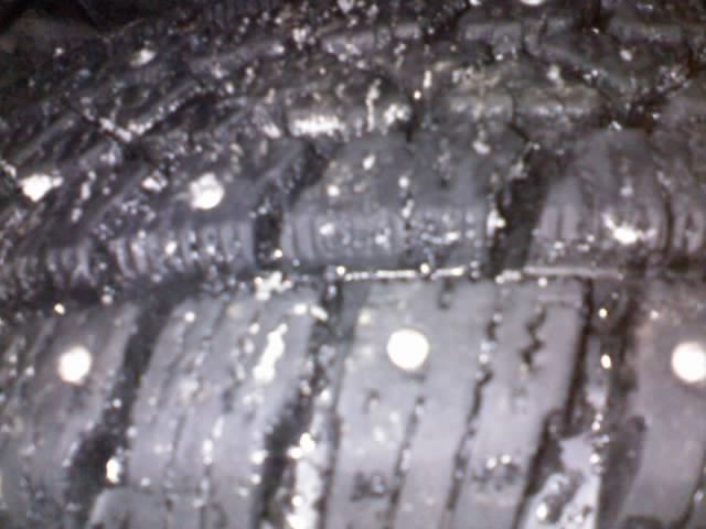

Winter roads are easy going in my car but the bike sucks on pavement. 10mph 1/8mi ride to the lake, it's a scary,wobbly ride with my feet down. if I had a clear shot to the ice I would have gone the 50$ parts and 6 hour labor route. (about 20sec. for a stud x 900 + dismount = 6hr.) I paid 300 used.
