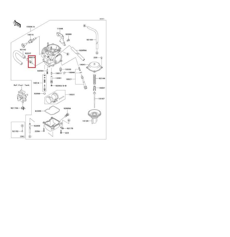

Its the main jet like Neil said. I saw that on a Yamaha a couple of years ago. The guy could start his bike but above a certain rpm it would cut out. He took it home, took it apart and the main was plugged. There is a filter.

Sorry for the blurry pic
