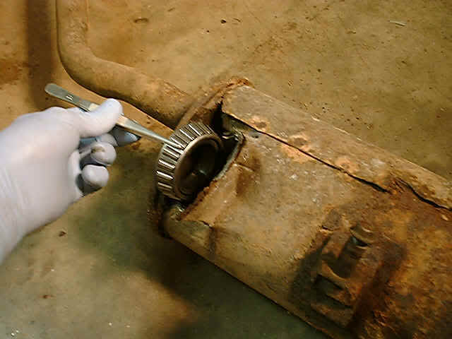

I don't know how many times I have posted this pic

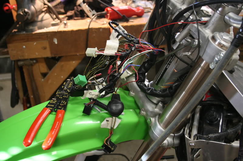

Red if you're talking about cutting the gob of 14 black wires that run to that plug, they all basically need to be connected to one another. There is a jumper in the plug that connects each wire to every other wire in the plug. Some of them come out of the plug and run to other plugs up front to provide a ground. I cut them all and ran new grounds to the things up front that needed one. There were six of the wires that ran back through the wire harness to other points on the bike. I soldered all of them together along with a connector wire to the other grounds.
I removed the 14 wire ground plug, the stock gauges plug, the ignition switch. the clutch switch, and wired in the X2 headlight and the Vapor. I was a little nervous doing so much at once. Thanks to my friends here, and TNC, for lending me some knowledge to get through the project with some confidence.
Did you catch that TNC??
Bike works like a charm (thank you baby Jesus)
First cut!! What am I doing?
I soldered the wires, and used heat shrink tubing to seal things up and do a neat job.

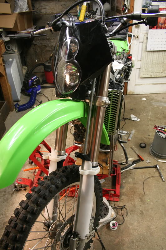

Going to look a little like this. Still need the hand guards etc.
