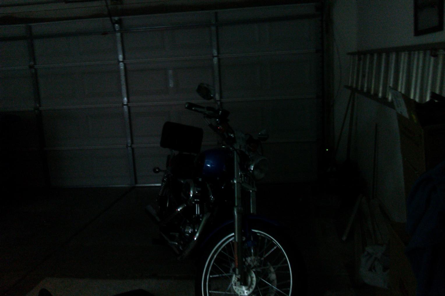

About the pictures:
Light in the garage at night
Color at day time- I love having a crisp colored lamp instead of dinge yellow.
3 Garage pics showing light output, pictures taken without flash:
1. Bike+wall+residual light.
2. My roommates harley being illuminated by residual light- notice the garage door behind the harley being illuminated. This door is 180 degrees behind the klx.
3. Actual picture of the garage with the HID Off. As you can see there was no background lighting.

About the pictures:

Pictures:
1. Ambient parking lot
2. HID. Notice roof and disabled sign.
3. Low beam. Notice the electrical box in the background vs ambience.
What temperature bulb did you go with? 35W at the right temperature should be fine for me. I shall have to compare the cost difference of 1 hi/low bulb vs 1 ballast. I know I can order a ballast, unsure of 1 bulb though.
