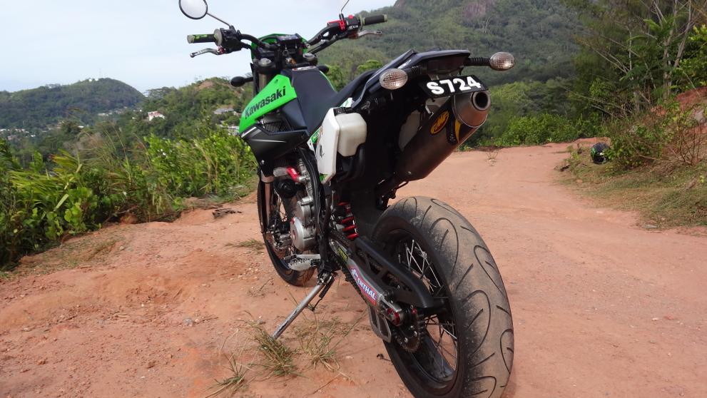

Thanks for the pics and advise Matt. Looks much better with the Pirreli's and am sure will handle street much better. Living on a tropical mountain island I go through sun, rain, tight mountain passes and flat out sections all in a 20 minute ride to town, so tires must grip!

The 120 & 140 are the best combo IMO. The Rosso 2's are also surprisingly good in the rain.
The 140 is about perfect but the rim could do with being a tad wider as the rosso's are quite a round profile tire to begin with. Even on a gocart track you will not completely loose your chicken strips! 150 does fit but overkill for me, it will distort the tire into even more of a steeper curve shape & add more unwanted weight to the unsprung weight/mass of our lightweight & under powered bikes.
The 120 on the front is again slightly distorted by the rim width & are definitely more rounded than they are meant to be, not even Marc Marquez at 60 degree lean angle on a racetrack could find the edge of the 120 tire on a klx rim!
But the gains with the 120 are better high speed stability, with a slightly slower more predictable feel when dropping into corners & the ability to absorb bumps & pot holes with ease.
ps. your speedo will read nearly 10% slower than a 110 tire!
My bike likes 31f & 32R tire pressures for general blatting about & throwing her around on the twisty mountain roads!
The bike on the left has a 150 Supercorsa & my bike on the right has a 140 Rosso 2.

Thanks for the great pics and comparison Joel. KLX678 has hit the nail on the head with different tire manufacturers and widths. My chain guard has a grooved section from my 140 Bridgestone and the chain is millimetres from the edge so I was very worried how guys are fitting 150's. No way a Bridgestone BT in a 150 would fit.
Yer the 150 does look cool but for me it's just to big for the KLX MiniMoto. If I was prepared to throw more money at the bike (which i'm not!), I would upgrade the wheels with wider rims. if your happy to distort the profile of a 150 in the name of looks....up to you.
