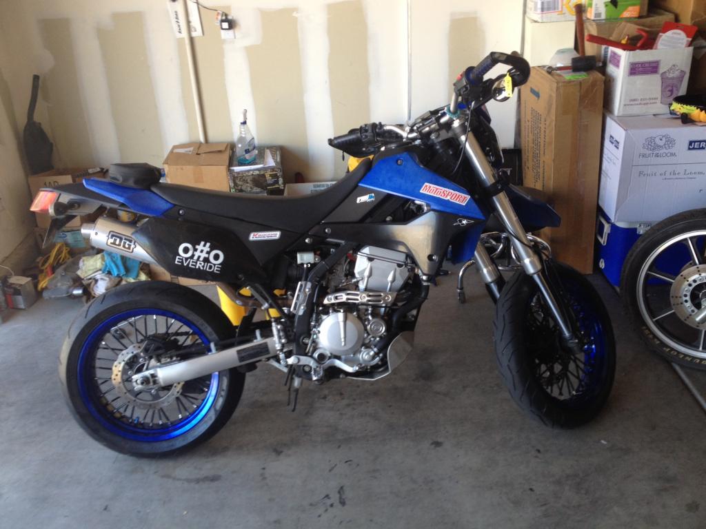

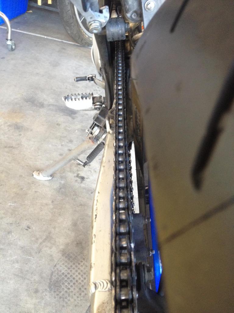

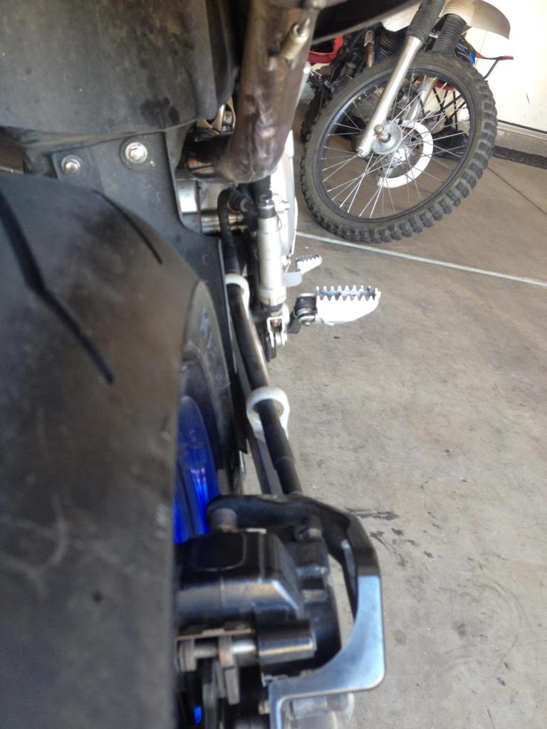

Exactly, that's why I decided not to fit a 150/60/17 rear because the ***** are so huge they are mm away from hitting the chain. The 140 diablo I had installed today has more room between it and the chain than the 130. So Graham, the 150 would most certainly fit, at least in the pirelli diablo rosso II brand

Looks like a real motard now!!!

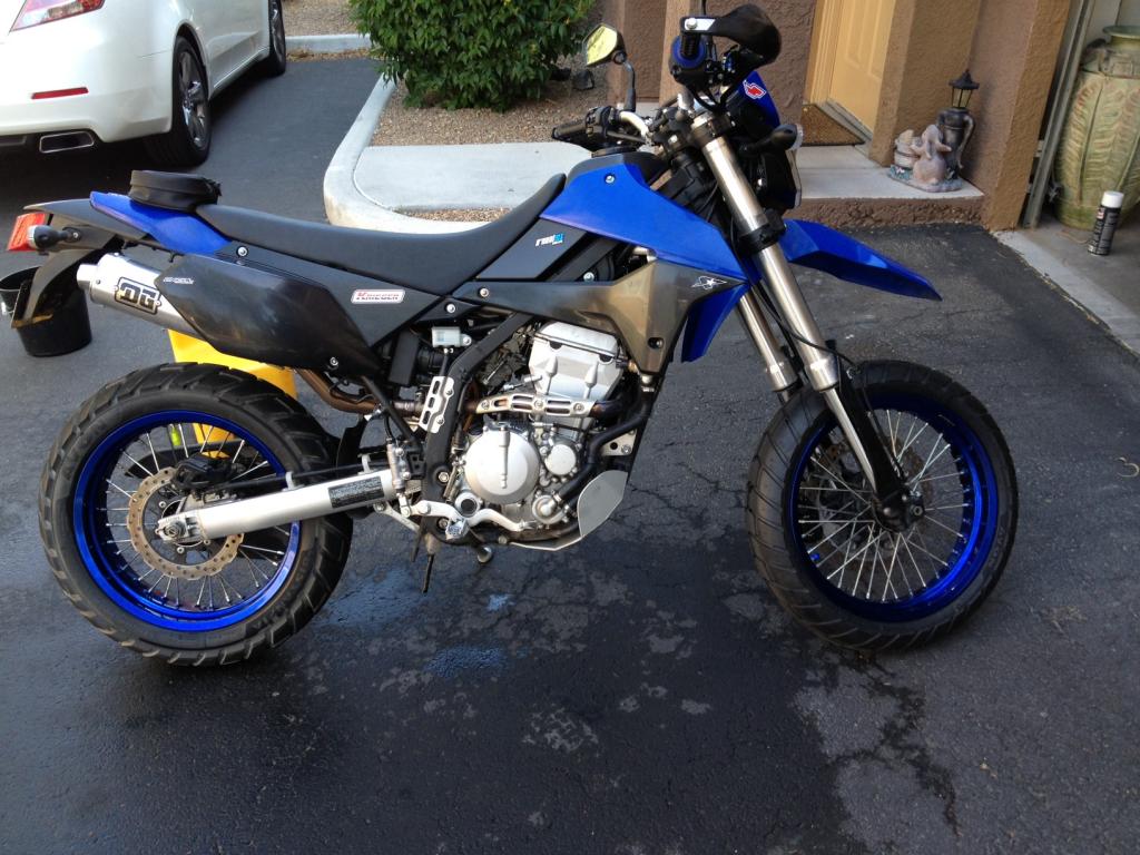

Before...
