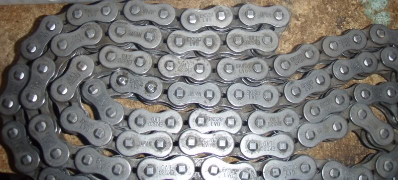

Here it is.

Shop manual says. . . . Enuma (which is EK brand). EK520LV-0, 106 links. . . proper chain slack. . . 55-60mm (2.17-2.36 inches).

Thanks Magoo, I guess I forgot I could have looked in my manual. I just looked at an oem parts site and it says:
92057 CHAIN,DRIVE,EK520LV-O
Doh!
But thanks for the info. I never heard of Enuma till now.
