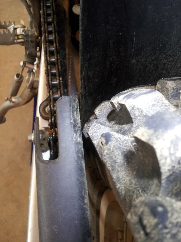

I've started studding my front tire, but I'm not going to have enough clearance on the rear with the studs I bought. I'm running Maxxis IT Desert front and rear. Any suggestions what might require a little less space than my 120/100-18, and work well in the winter?

You could try getting some flat stock and making a shorter set of suspension links. That would raise the rear of the bike up, for very little cost too. If you have endless coin, you could lace up a smaller rear rim and get a tire to stick on it. Not sure if you can find a 16" coarse tread tire, but I'm thinking you could. Otherwise I got nothing.
Here's another thought. I'm on my second Shinko (Golden Boy) 3.5 x 18 trials tire. Picked up both cheap from CL. It is definitely smaller diameter and the trials tire runs great in the snow. red said he didn't like a trials tire in the snow, but I was impressed and did much better than buddies with their regular knobbies: https://www.kawasakiforums.com/forum...-tire-s-35829/

Kenda makes the 270 dual sport tire in a 4.60-18 and 4.60-17. If it is anything like the Yokohama I had, the numbers are deceiving, because you'd think it was a 4.60" wide tire, but it's not. The tire is 4" wide with a low profie as indicated by the .60. I don't know if it was a 60% profile, but it was really low. The tread should be good for the screws too. Do some research on this tire to see if it is low profile or not.
I don't know for sure, but Kenda may have bought the tire tooling from Yokohama for their tires, so I am not sure it is the same low profile I had. I know Shinko got some of the tooling when Yokohama quit doing motorcycle tires, maybe Kenda got in there too.

Thanks guys. I don't think height is my issue as much as width and swing arm length. My Maxxis is 5.25 in wide, so something like the Kenda might be just what I'm looking for.

The pic of my front tire is from when it was only partially done. I ended up doing one stud in every lug, with the exception of the far outside lugs. For those, I did every second one in order to save a few studs, until I know how many I'll need for the back.
Someone correct me if I'm wrong here: Stock rear size (according to TotalMotorcycle.com) is 100/100-18. If I go with that, instead of the 120/100 Maxxis IT Desert I have, I should gain 10mm of clearance on each side in theory. If I can find something that has smaller lugs on the sides, or a different angle of lug than my IT Desert, I should have lots of room. Right???
