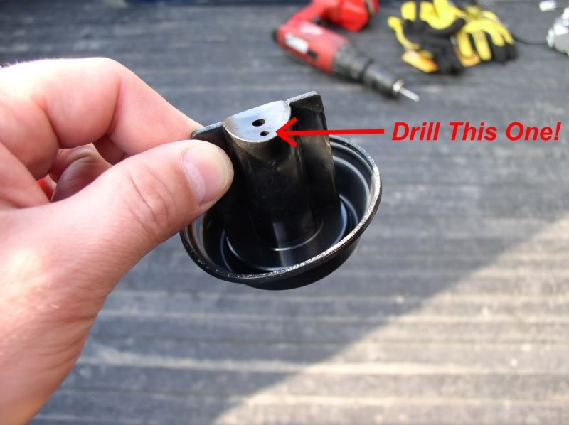

I am looking inside the float bowl on my 06 250s===I am looking at the dynojet kit installation instructions and I dont see the passage I am supposed to drill to 7/64th WTH!!!!! is it the passage in front of the main jet? if the mixture screw is facing forward is it the passage in front of the main jet?
I think i was looking at the wrong thing------do I drill the plastic body hole next to the needle?

The hole is in the slide not the carb' body. Drill the hole next to the hole the needle comes out of.

All I can say is WOW==========after finding that my head was up the wrong hole while looking at the wrong carb part ====I drilled the slide body, reassembled the bike and I am very satisfied with how the bike runs===and the power finally I might scare myself on this bike now. I do notice I am a little lean at idle and I am at 2.5 turns out on the idle screw, if I blip the throttle it idles at 1800 rpm then drops to 1400 rpm after 3-4 seconds===
but since I did not buy a kouba screw.......its going to idle lean for now
