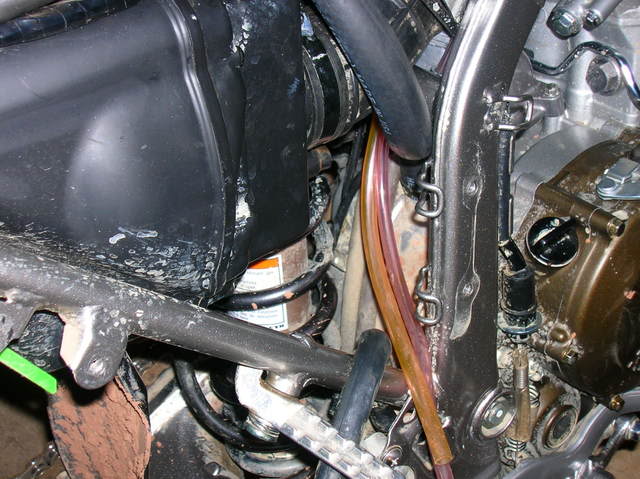

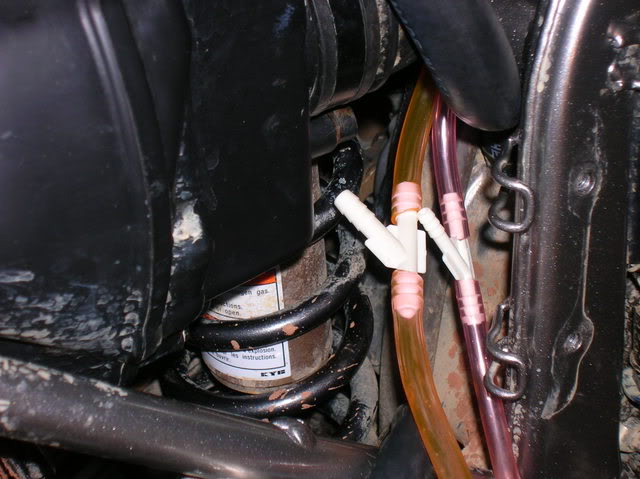

Carb tube T-mod. A couple of us did this before a wet and wild ride two years ago, glad we did. Any hose hanging down that can potentially pull water needs to have the T-mod added to it. However if you turn your bike into a submarine, nothing will keep water out of the box. Just ask Tony....Right Tony?
Old Oct 27, 2008 | 09:16 PM
This is from Dirt Surfer
go from this:

To this:
Then just run the other lines up to the top of the airbox.

Are you then capping off the lines that go under the bike.
I geuss that makes sense. The water was definitely deep enough to suck water into the carb vent lines. i will have check it out.
Are the vent lines there to suck in air or dump fuel?
Old Oct 28, 2008 | 09:32 PM
ol guy's Avatar
Joined: Nov 2006
Posts: 741
The lines will still be open at the bottom, the high lines break the vacuum if the low lines go under water.
