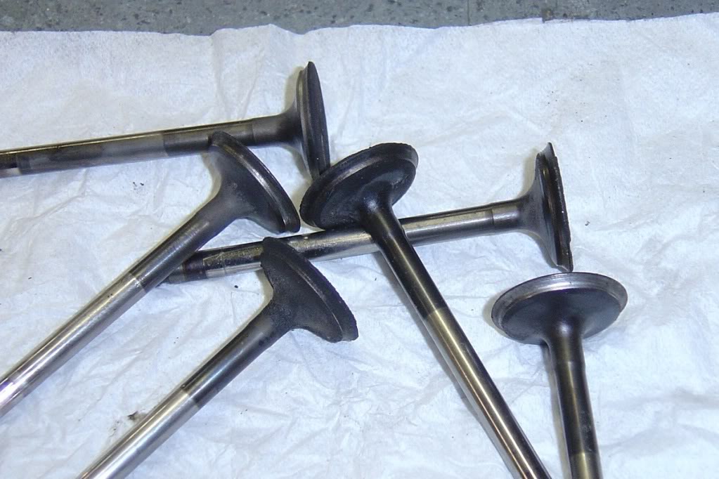

The answer as to what ultimately happens when clearance max's out is usually that the valve has mushroomed. I haven't worn out mine personally, but I've seen some decent reports from others who have. Most of those cases I've read reported that the valve kind of gets "beaten out" against the seat and deforms in a mushroom kind of shape. In this case the seat is harder than the valve, and the valve wears before the seat. Seats can also wear out, but in many cases it's the valves that are the wear items. Valves can be replaced and surprisingly even seats.

Here are some intakes I just pulled out of a 2003 Suzuki Carry minitruck w/ 30k on it. Same thing, could not get a .002 gauge in them a year ago. Reshimmed to the thinnest shim they made (got .010 clearance) and a year later truck wouldn't start again. It got new valves this time. I think they got a batch of soft valves.
