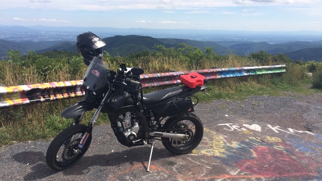

Lynx has been fitted to a 2009+ KLX as i was the prototype install, PM me for info/help.
http://s23.postimg.org/lj3vn17d7/IMG_0029.jpg
