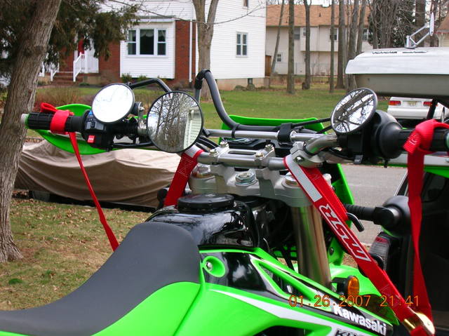

I ended up tapping the weights in my handlbars to fit the 8mm screws that came with it. Made for a real solid fit...
Tapping the weights?
Old Feb 13, 2007 | 09:41 PM
DirtSurfer's Avatar
Posts: 563
Default RE: Tusk D-Flex handguards
ORIGINAL: JB1
ORIGINAL: DirtSurfer
Yep, About 15 min on each side with a tap and some cutting oil. The 8 MM bolt fits right in nice and snug.....
ORIGINAL: JB1
Did you just tap the existing slug in the stock bar end, (thatsome have drilled out), and not have to use the after market bar end inserts?

ORIGINAL: mmatz
ORIGINAL: JB1
Tapped directly into the existing slug in the end of the stock bar, (after predrilling out a bit using the 8mm sized pilot hole drill bit included in the tap and dye kit for the 8mm tap)

DirtSurfer,
So stock bars with Tusk D-Flex hand guards and no cables rubbing or binding?
Old Feb 15, 2007 | 05:51 AM
DirtSurfer's Avatar
Posts: 563
ORIGINAL: mmatz
DirtSurfer,
Correct...
The only thing I changed out was that Iwent with shorter 8mm bolts since I didn't have to use the expander mechanism that comes with the handlebar inserts.1.5 inches into the slug was ample holding power since the slug (weight) is welded in to the bars so well...
