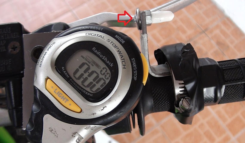

Testing out my newest timing technique; which is having a stopwatch mounted next to the throttle atop the RH mirror mount with its' Start/Stop button actuated by something clamped to the throttle.. I made some short sprints from a 12 kph roll trying it both with/without the big K&N air filter.
The difference w/o the filter was just .01 sec, so it appears the K&N is doing an adequate job of providing air.

Testing the 36 today with no inserts in its spigot, a couple sprints tried from 16kph instead of the usual 17 (couldn't quite hit 17 kph at the start) before I had to get ready for kidney dialysis netted times a few hundredths slower than the 36s previous 5.12 with the short (.5") middle vertical divider. I don't think the 1 kph starting speed differential made a whole of difference? but you never know I guess.
The third run was aborted after a giant wheelie following the 1-2 shift..
I have ordered a shift light from China today;- that combined with the throttle triggered stopwatch should make future testing effortless and very accurate, as once I see 17kph, I'll just hit it and back off of WOT when the light comes on the third time at the top of 3rd gear.
The stopwatch install is lo-tech but has turned out to be a very easy way of measuring performance changes. I am going to combine that with a shift light so I won't need to mess around with hitting my starting line at 17kph-just crank it to WOT when I see 17kph and off WOT when the shift light comes on for the 3rd time near the top of third gear.
