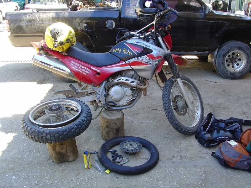

You are right that the dirt bike spoked wheels do not get balanced anyway, so maybe I should at leasttackle the KLX tiremouting on my own. Is is hard? I have never mounted amotorcycle tire before. Auto tires yes but using a Cotes Machine and I do my mountain bike all the time but that's a piece of cake, lol. How hard is it to take the tire and the tube off and then put the new one one. Does it slip right off and on like a bicycle tire?
I always carry three tire irons, patch kitandbicycle pump in my tool kit. Sometimes also a 21" tube. You gotta be able to patch a flat on the trail.
Get three nice spooned 7.5" tire irons.....don't go cheap, mine were almost $15/each. But they work great and have MORE than paid for themselves....you do not need longer spoons, because if you do you are doing it wrong, it's all technique and practice.
There is a great video out there, that I used to have saved in my favorites, but no more. [:@] Hopefully someone will post it up.....it was a professional guy at a mx track demonstrating proper tire changing technique.
First time is tough, second time A LOT better, third time and on a total breeze.
I even carry my repair kit on vacation, here's a pic of me fixin a flat on a rental bike in Costa Rica.....it would have taken forever to get someone to do it....if at all.I was back in the rain forest within an hour. You should be able to see my spoons in the pic....get the same or close.

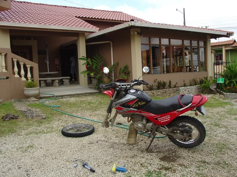

I actually got two flats on that trip. Back tire repair Costa style.
