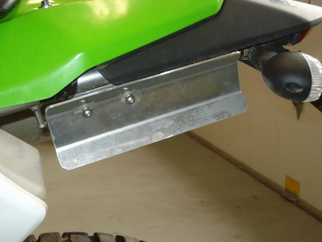

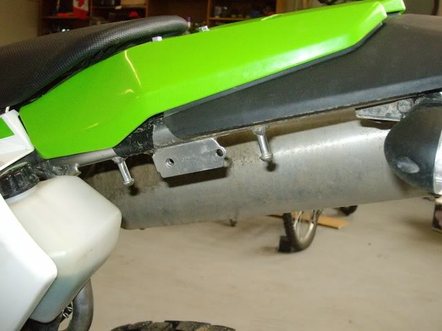

I finally got around to making a new tool carrier. I decided to use the tab that used to hold the helmet lock because the space was crying out for some use.

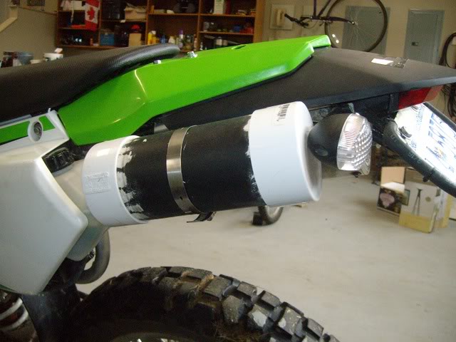

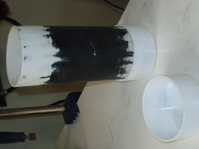

I made an aluminium bracket to bolt to the helmet lock tab and bent it to fit a piece of 3" pvc thin wall pipe I had laying about. I glued one sewer cap on one end.

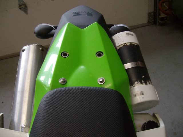

I used a hose clamp to attach the tool carrier to the bike.

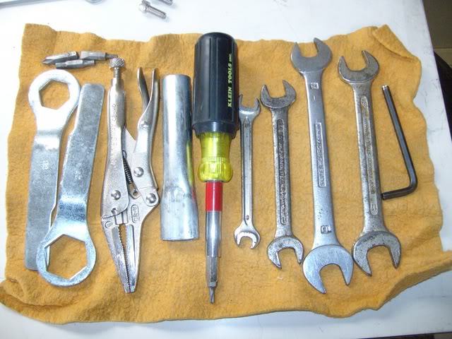

I can fit in enough tools to do anything i need to do to it in the backcountry
Plus some spare fuses, bolts, tape, jb weld and that kind of stuff, and still not make it too heavy for the tab. (hopefully)

good job with that. I'd lose those axle wrenches and just use an adjustable wrench. I have a nice Stanly that's no longer than your screw driver($10 at wallyworld). It will also do the work of all those box wrenches. I'd throw a few zip ties(large and small) and some electrical tape in there too.
The one other thing I noticed that you don't have is an 8mm socket or ratchet. Those are good to have too.

The 1/4" ratchet and a couple of sockets are at work but will fit in as will the other stuff you mentioned. You can pretty well strip this bike to the frame with an 8mm socket.
I have the crescent wrench as well but I like the box end and the little extension fits over my tire irons which I might just cut down so they fit in the tube and use the extension for leverage.
I will also carry a tiny voltmeter and some electrical connectors etc. Also a tire pump and patch kit.

Update on this bad idea,
I was just going through some old posts and found this. I have to tell you that the helmet lock tab broke off one my trip along the KVR so this is not a good idea.
Old Jun 6, 2010 | 01:39 AM
RaceGass's Avatar
Posts: 1,392
You still have a great idea there. You just needed to add one more slightly beefier tab rearward of the helmet tab, weight over stressed the one tab is all. Plus it looks like that tab is only welded on the back side.... even a hose clamp and a small bracket would probably suffice to bolster the helmet tab.
Now its time for your new and improved version.
