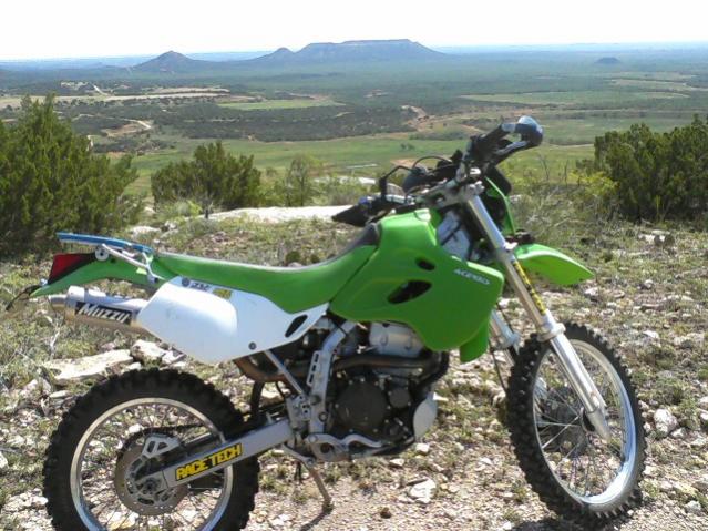

Got back from the 3 day riding stint out at the club's riding area. Got to ride with a bunch of the other club members. They get a kick out of me having the only street legal type bike out there. It's funny riding around with KTM's, CRF Honda's, KX's and such. I always come back from these weekends with almost no pics. If I'm doing a ride alone, it will be just scenery pics, and if I'm riding with some of the other guys, we don't stop for picture taking sessions. But I did at least take a couple. The one with the 60 mile sign is where you're about 2/3 completed in our annual state enduro. Overall there's about 100 miles of singletrack out there, and a good bit of it is downright gnarly. The recent heavy rains really left a lot of exposed rocks and roots. Some of the climbs were really loose and challenging.
