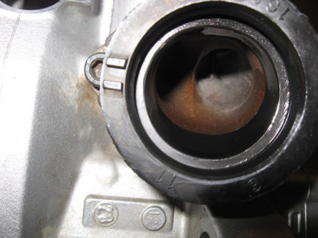

I don't know about your TM33. On the TM36-68, I used needle nose pliers to direct the squirt nozzle at the needle. It was squirting high and to the left. I don't know if this could be the bog. A mechanic I was speaking with a couple weeks ago said the squirt should be directed at the center of the "V" in the intake (pic below). But how would one fine tune that without mirrors and magic? Striking the needle makes more sense as it seems like the fuel jet hitting the needle would be more likely to atomize. But what do I know?
