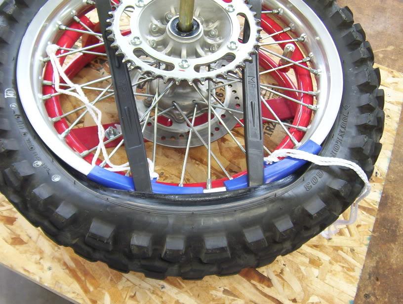

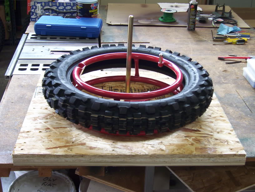

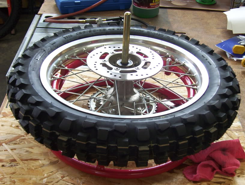

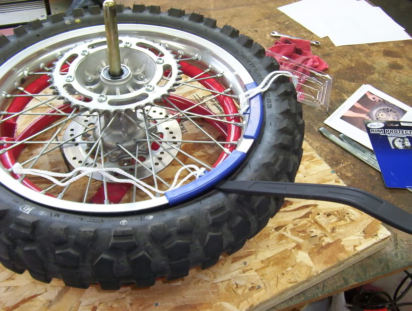

I actually have 4 irons. Two long and two short ones. Here is a little trick I learned while changing one of my tires. Use the sprocket to hold the tools while you get another grip. Unless you have a 3rd hand. Also this Moose tire changer is awesome for holding the wheel, I mounted it to a piece of plywood. Here are a few pics. I have the two 16 inch and two of the 8n inch spoons.
