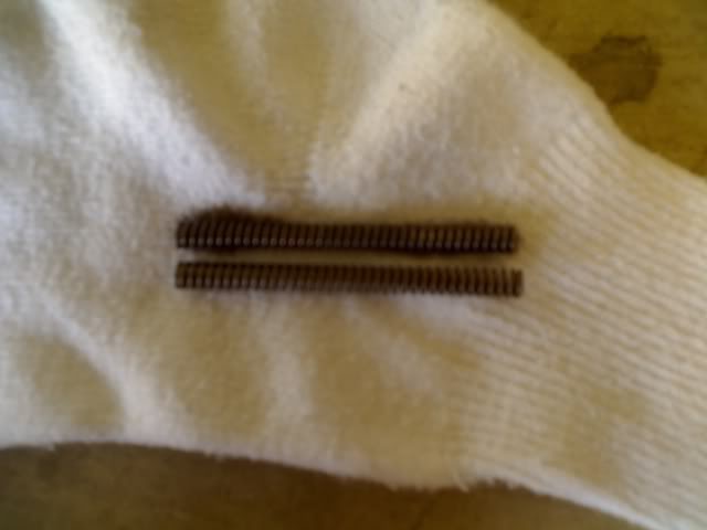

Old and new Cam Tensioner spring lenght. The old one measured 2 1/2 inches while the new spring measured 2 9/16 inches. Just a 1/16 inch longer than the old one.

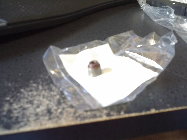

On a later fix, Cam Valve seals. Part # 92049-1349, about $7 each seal

What are the valve seals for? Is it starting to smoke?
This is actually another problem that my KLX engine has had. If I don't start the engine up about once in a week, it would smoke a little during startup. Since it only does it when sitting for a week and only at startup, I suspect there maybe one or two worn seals. After 15 seconds of startup, the smoke clears and the engine runs good.
Since I will be tearing into the engine so much. It would also be a good time to replace the valve seals as well. More on this, is to come.
