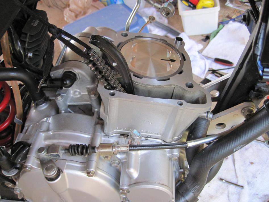

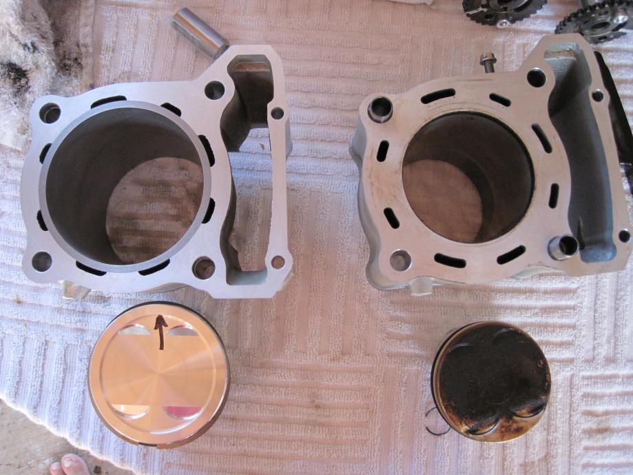

Woo hoo, 351 klx 250sf, almost done. All put together, and I started it up just at dark. I warmed it up for a few minutes and changed the oil. It's not idling, I will have to trouble shoot this, and then start to break 'er in! Very stoked about the fact that it doesn't appear that I messed up and it started.
Got all the smog stuff off. I read one thread that mentioned to use a hose clamp to compress the rings. I didn't want to chance scratches, so I used a big zip tie, slipped the cylinder on and then clipped the zip tie. Worked great.
Thanks again to you guys who gave input and guidance.
attached photos- old n new cylinder an piston, 351 cylinder on the bike.
