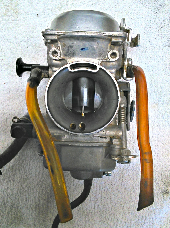

Here are the two vent lines, left and right:

I got a kit of plastic T's and 6 feet of 7/32-inch ID windshield washer hose at O'Reillys. Used 51 inches of hose and 2 ea. 1/4-inch T-fittings.

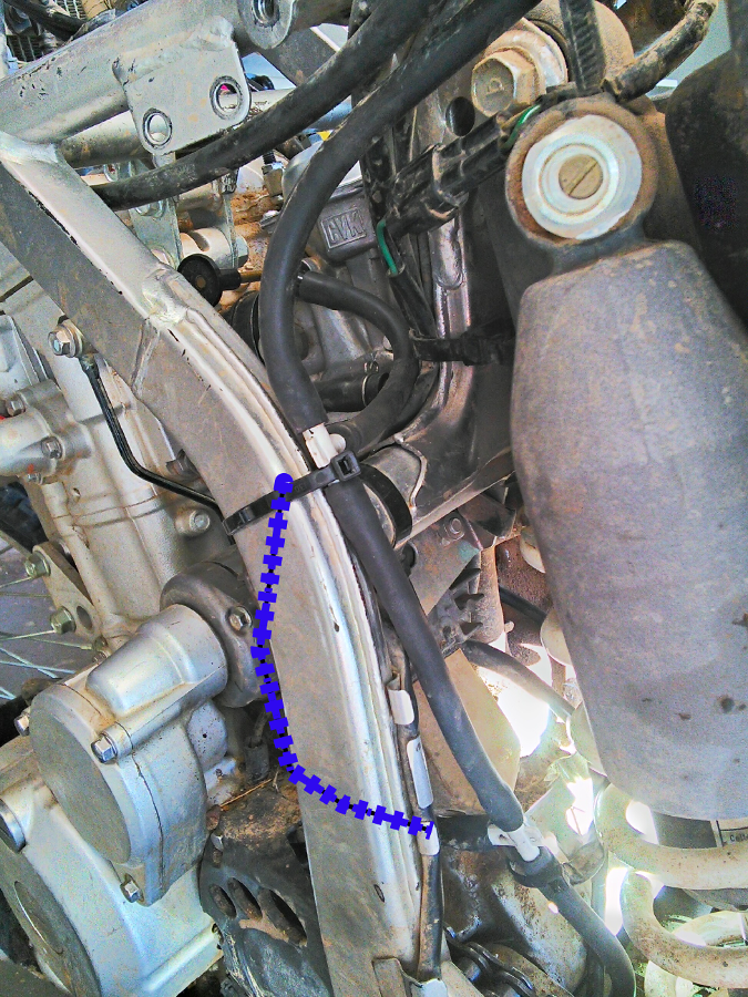

The right hose runs down over the starter, staying away from the exhaust, and hits a T in the stand pipe:

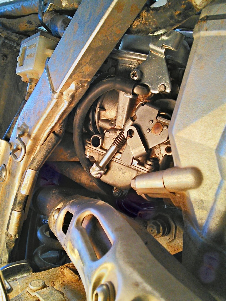

The left hose runs down and hits another T just above the swingarm:

Above, I drew a dashed line to show the route of the right hose.
The stand pipe drains downward between the swingarm and shock so it stays away from the chain. The top end runs up around the airbox and ends by the fuses.
Everything drains downward. Should be good to go for future water crossings.
