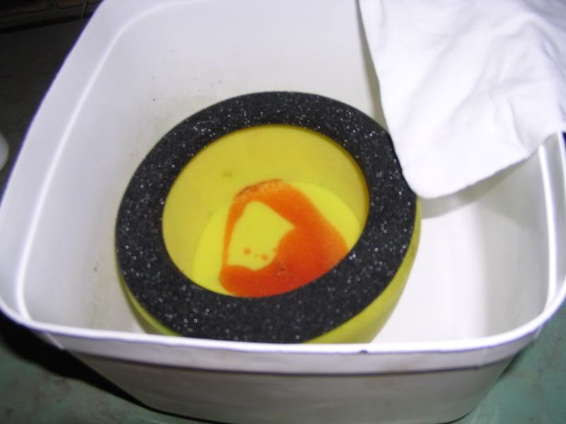

I just ran across an interesting video regarding No-Toil air filter oil. Some guy does a couple "dunk tests" with different filters and different oils. The No-Toil air filter oil just lets the water pass right through the filter. The more traditional filter oils totally stop water.
Here's the video: http://www.youtube.com/watch?v=fpzK6Wm_BDs

The first 2 filters had no oil on them, I used No-Toil for my last filter clean and it is red as you can see by this pic

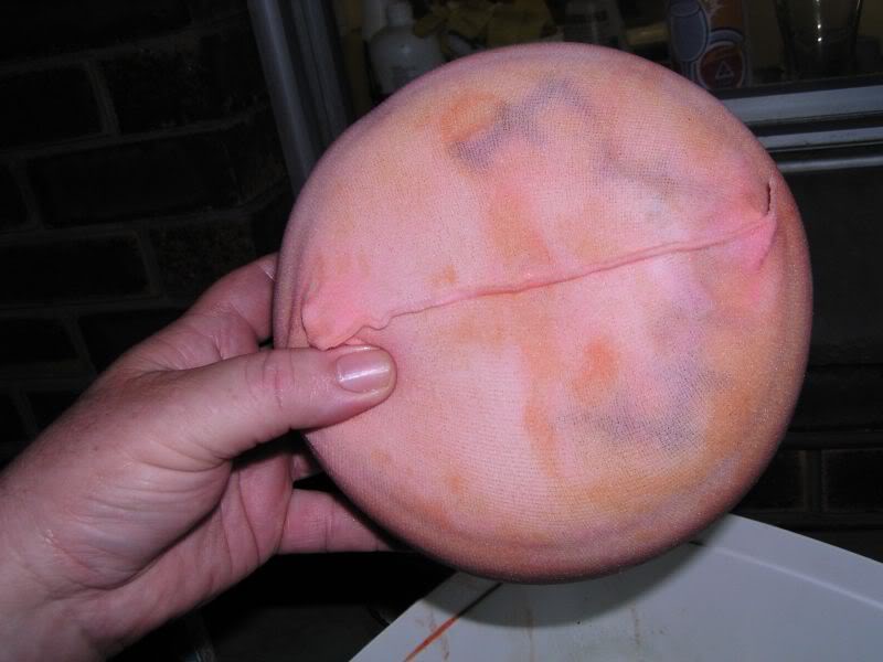

The following is with the filter sock in place over the filter but you can see that it is red ... unlike in that video
