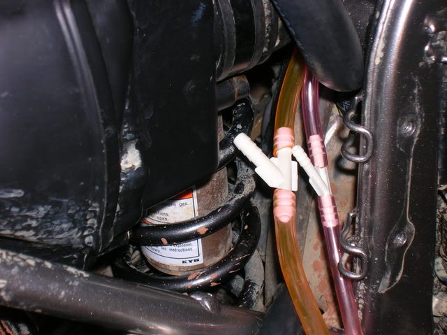

I just used the "Y" fitting from the help section like everyone else. Remember these are vent lines, its not like gas is flowing thru them.
https://www.kawasakiforums.com/m_100000/tm.htm

Yeah, I guess plastic is OK... Gas doesn't flow thru it, but when you lay the bike over gas might start pissing out of the vent lines...
So, if the bike were upside down, the gas might come out the top vent, and soak the seat foam or something...

lol...if your bikes upside down you have MUCH bigger problems
