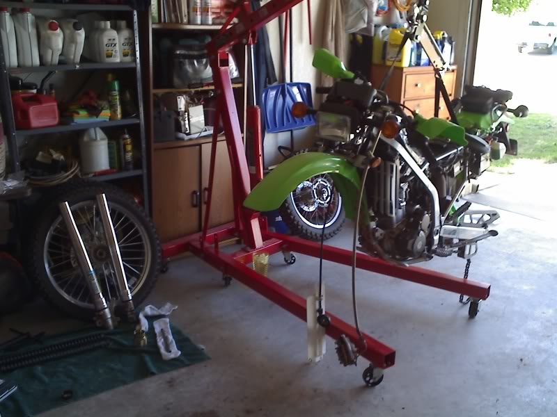

Prepare the KLX and lift it off the ground.
Step 2:
Remove the wheels.
Step3:
Remove the fork tubes. But before removing them competely, remove the handlebar and loosen the fork tube cap.

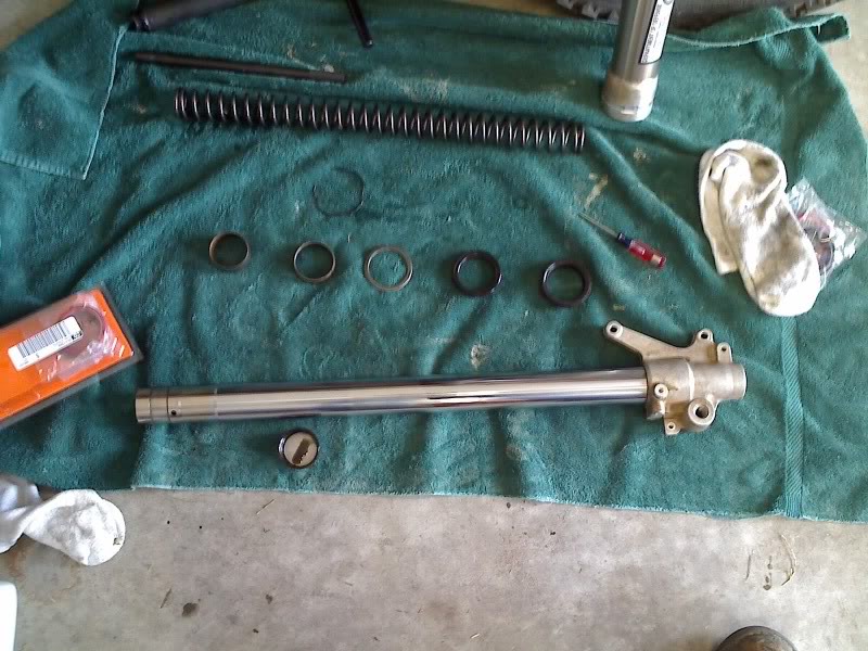

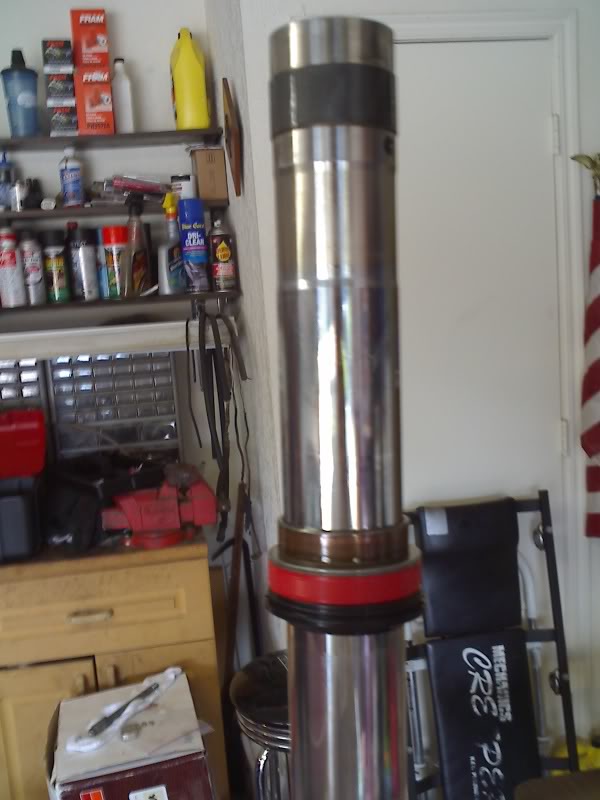

Disassemble the fork tube. The picture shows it already disassembled. So in this order, un-screw the fork tube. Slide outer tube down. Take a 17mm open wrench to the nut on damper shaft and un-screw the tube cap from the damper shaft. Then remove the spring. Tilt the fork tube down to pour out the fork oil. Push in and out on the damper shaft 10 times to help remove all the oil. Take a small straight slot screw driver and pry the dust seal away from the outer tube. Take a small straight slot screw driver and pry out the clip on the inside of the tube. Lastly, take the outer tube and slide it upwards till the oil seal pops out. Be careful, it will be a sudden seperation.

Place new parts on the inner in this order. Dust Seal, Oil Seal, Washer, Spacer, and the bushing.

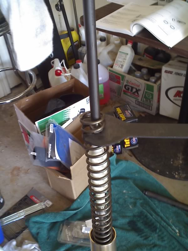

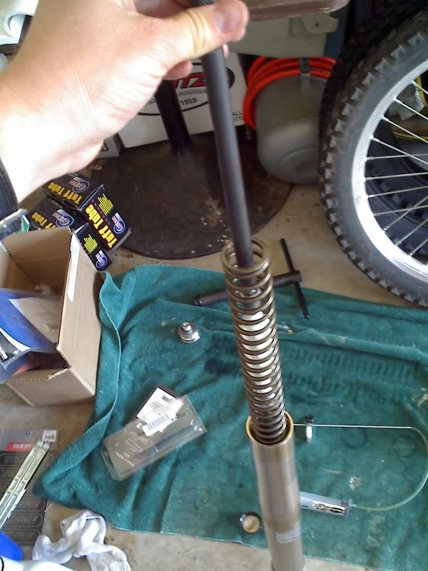

Time to re-install the spring. Using a damper shaft extending tool to help make this a little more easy.
Step 9:
Slide the spring back in the tube.
Step 10:

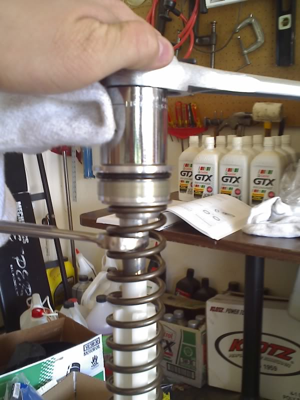

Slide the spring holder tool into place and start the screw treads on to the tube cap.
Step 11:
Gently tighten the cap back on to the damper shaft.

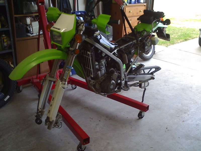

Reinstall the fork tube back into the triple clamp. Make sure you align the marks left on the tubes. Tighten the clamps, and then tighten the tube cap, and then re-install the handle bars.

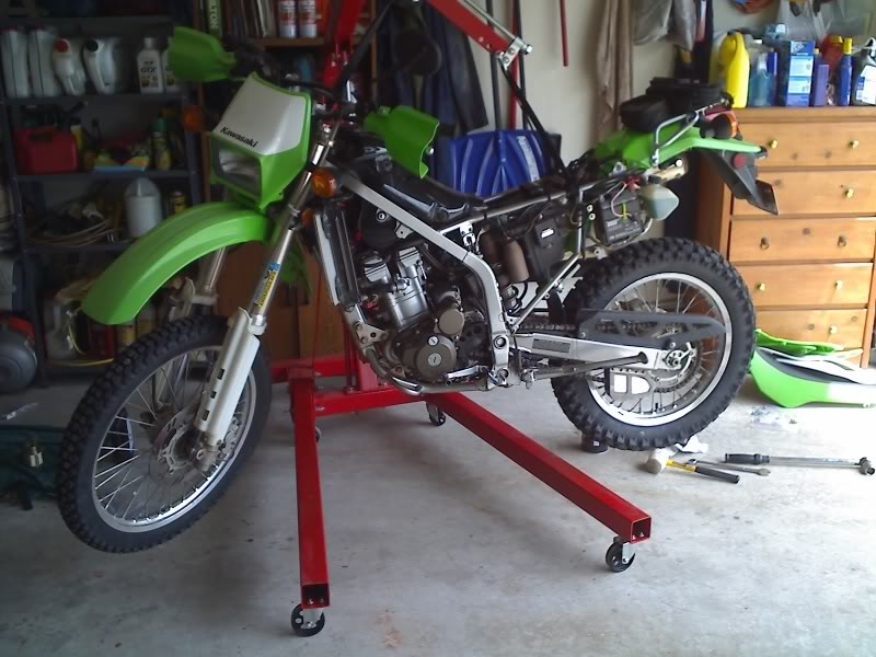

After everything is completed. It should look like a motorcycle again. Like this:
After the test drive, the KLX definitely feels like a different machine. I changed the fork oil from the OEM 5wt to 10wt. Which should help dampen the forks better and slowed down the nose diving on braking. With new tires, the balance is not the same. I think the front tire has a heavy spot and feel to lump on the road. Then again that could be from the change of fork oil that maybe now that I'm feeling more of the road. I will give 200 miles to see any changes. If no changes, I take the front tire off to be balanced to see if that does help.
