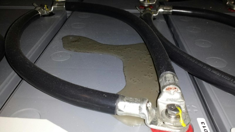

Your nose is correct. It's bull. If you keep "any" brand of battery with a shorted cell in the bike for too long it will kill the rectifier/regulator. The rr is sized to support the power needed to recharge a battery that was just discharged by the starter. If you try to pull full power from it for an extended time, it's gonna fry. A fully charged battery is 12.7V. The charging system puts out more voltage than the battery has, so the current flow is "to" the battery. There is no way a "good" battery can fry the rr. Even if it's an off brand. Feeding 18.7V will fry a battery in no time at all. You'll boil it dry and get that egg smell. The kawi spec is a tad high for the rr output IMO. You need above 13.5V volts to charge with 14.5V being the max you want to see. Kawi spec is up to 15.2V which I wouldn't be happy with, but they consider it ok.
Yuasa is a good brand, but any brand can have issues. Their large sealed lead acid business was sold to Enersys 10 years ago. Same factory same quality as far as I can tell. I installed 800 batteries in one project and a year later 1 went bad. It didn't fail, just leaked. This is hard to do when you're a VRLA battery... but it happens.
Attached Thumbnails Sulfur smell leads to dead battery, roadside rescue-20140710_111748_resized-custom-.jpg
