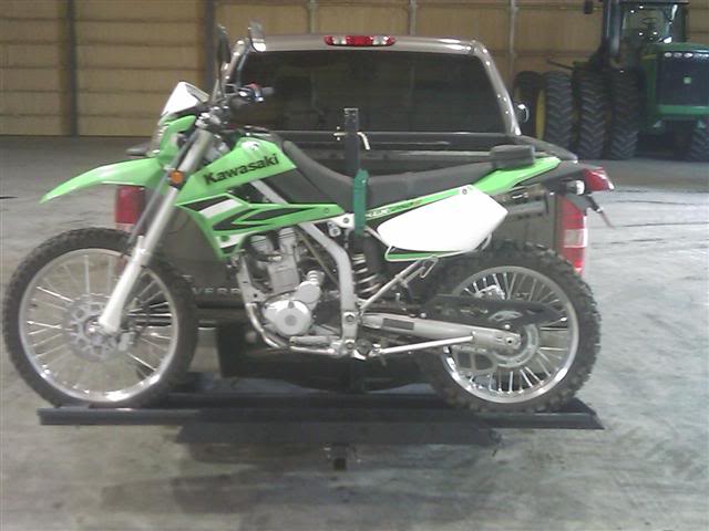

Sorry for all the ?'s Here's a pic of my homemade hauler.
